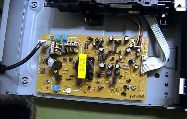

Got a Sharp DVD player model DV-740 that had gone bad. Switched on the wall plug, no standby light, unable to power up the unit. Suspect some components on the power supply board are dead. Any service manual, schematics & advice?

Don't have the schematic nor service manual, but from the picture it appears that there isn't any switcher IC?? Either that or it's under the board... you'll be very lucky if it's a 'discrete' switcher - good probability of getting it fixed.

Hi, Thanks for the reply. The switcher IC should be the one near the big capacitor. I have changed that. I think the big capacitor maybe the problem. Now i recalled seeing some electrolyte coming out of the base.
The big capacitor would be your mains filter. Mains power comes in, goes through some line chokes (Toko) and line capacitors (the blue ones), then into a rectifier (the four diodes near the two Toko). That should be a 350 or 400V electrolytic, maybe 220uF... Is there rectified DC on it? It should be about equal to (your line voltage * 1.414).

You are lucky,dude😀 .It a Fairchild Power Switch(FPS) based SMPS that's definitely a stable stuff and easy to repair incase of failure.I suspect that the start-up resistor might be open circuit.But if so,PLEASE BE CAREFUL as the the electrolytic caps might store a few hundred volts of DC and make you jump around
Your part number should be the popular KA5x380R.I attached the link for your reference.

Hi, thanks for all the input, the big capacitor is OK, no electrolyte leaking from the base. I think the manufacturer had put some kind of glue to support it. I have mistaken that for leakage. The rest of the capacitors look fine to me, no bulging.
There are no voltages output from both connectors (the color one & the white one). This kind of make me think that there are some components on this board gone bad.

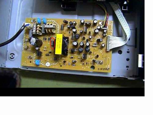

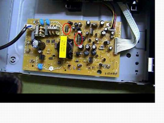

Are these diodes (circled in red)? Their legs are black, maybe they are burnt. I did ask some of the electronics shops but they can’t tell the rating. There are “10 1H” printed on it. Any idea?

Those that you have encircled are diodes - highly doubtful that there is anything wrong with them (on the basis that each one will produce ONE output voltage, but in your case ALL output voltages are not there).
It is highly probable that the PS isn't self-starting, just as Leolabs has said. Check the startup resistor (get the pdf and read through it).

They maybe out or may not.You need a DMM with a 'Diode Test' to prove them.Those are usually schottky diode,can be subsitute with this part number,SR360.
Anyway,did you check on my link provided for you???You need to make sure the primary side is OK first then you can proceed to the secondary side.
Still,take my words:check for open circuit start-up resistor first.🙂

Assyst1606 said:Hi, i have read thru'. I'm not good at this. Wonder if this resistor (circled in red) or those before the transformer belongs to the start up resistors? All the resistors look fine to me, no burn mark.
Maybe it's just a snubber resistor.Here's a hint,just look for a high value(usually a few hundred kiloohms) resistor that connected to the pin3(Vcc) of the IC.
