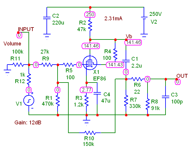

but i'm not really sure about the right way to "strap" a pentode into triodemode..?
Place a 100 ohm or thereabouts between (going from) the screen grid to the anode. Since you need only 6-8dB of gain with these types, you will have to apply quite a bit of NFB around the tube. This is what I have done in my simulations. And also with the cathode resistor bypassed and unbypassed. Bypassing the cathode resistor will result in a lower output impeadence but also higher gain. There is always a little trade-off in the world of electronics. Now since I could not sim the 6AS6, The EF86, which by the way is a very good audio pentode, and the EL84 I simulated should give you a general idea as how to proceed.
The maximum rated anode voltage for the 6AS6 is 180V, 140V for g2 (screen grid). So therefore you would want to bias, set the operating condition so as to have approximately 66% of your supply voltage minus the cathode voltage. For example if you have a supply voltage (B+) of 180V, you would want around 120V sitting on the anode and nearly the same on g2, between the anode and the cathode in triode mode. I'd say you could use up to a 220V supply without any problems.
IMHO I wouldn't choose the 6AS6. The 6CB6 would be a better choice I would think, but hey go for it! You could use g3 for some interesting duties. Another subject for another time!
The schematics for the EF86 could be used for a 6AU6, should be pretty close with maybe some tweaking of the anode (load) resistor and the cathode resistor. Same for the 6CB6. So have a look at the schematics that I will be attaching and feel free to ask any questions you may have! I see from your profile you are into hamradio, tubed or sand?
The first schematic was an EF86 strapped in triode mode at 2.31mA with the cathode resistor bypassed. You can leave out the bypass cap (47µf) and reduce the gain to 10dB but at the same time it will raise the output impedance. You could use a 6CB6 in it's place but you will have to adjust the anode and the cathode resistors. This schem should "mate" up well with a 6AU6!
And another reason I would prefer to use a 6CB6 is the much higher permissible operating voltages! The bad thing is that I don't have any curves of the 6CB6 operating in triode mode. If I had a good spice model/subcircuit I could derive a few curves. :xeye:

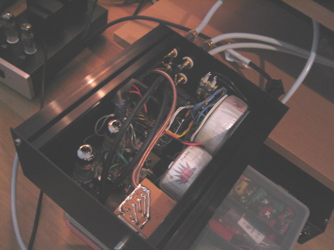

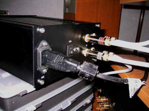

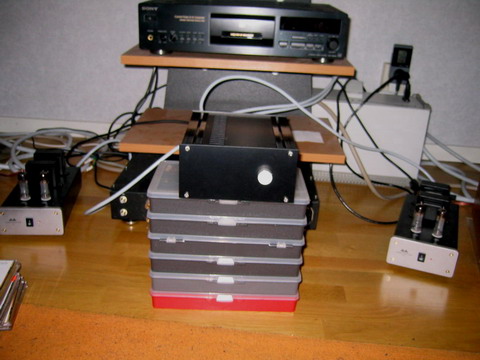

Hey guys! thanks for the circuits cogsncogs!!
this morning i woke up with SRPP on my mind..
so i went for a "simple" SRPP with 6CB6 with 130V on the plate and 180 ohms for each tube, and... it works... and sounds superb!!
so i have saved those circuits cogsncogs, thats my next project!!
here's a picture of the creation:
(it's the box in the middle...😎
I might mention that R8 (91k) and C3 (100pf) is the standard IHF test load from long ago... R6 (22R) serves to "isolate" the load, capacitive mostly, from the feedback loop.

😎 The outside looks great, except you can't see any tubes! For all I know you could be hiding some sand in there! (joking) Now let's see it's guts! 😀
Wayne
