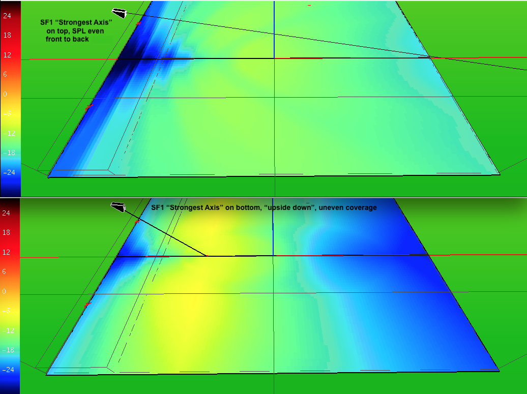

As previously mentioned, the SF1 diffraction horn is designed for asymmetrical vertical output, the “strongest” (most loud) axis being at the top (wider) exit of the slot.
An asymmetrical device’s output should “look messy” when measured in the same fashion as a symmetrical device.
The SF1's asymmetrical vertical exit slot also requires it's radial baffle either side to work as intended.
Looking at the Danley Direct SF1 coverage plots shows how well it works for it’s intended use, that of even front to back coverage when elevated above the coverage area, "strongest axis" aimed at the back of the coverage area.
Flip it “upside down”, and the level drops like a rock by comparison, or as you might say “the response gets REALLY ugly”. ;^).
Also notice how the SH95, (or any vertically symmetrical coverage horn) when aimed at the back of the coverage area is not nearly as even as the DF1.

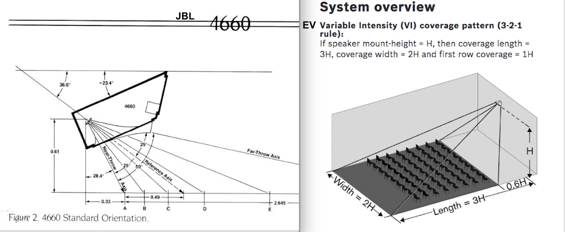

Based on Don Keele’s work leading to the 1983 white paper:
http://www.xlrtechs.com/dbkeele.com...rint) - Horn Covers Flat Rectangular Area.pdf
the JBL 4660 and the later Electro-Voice and Altec “Variable Intensity” high-frequency coverage patterns are symmetrical from side to side, but skewed front to back in such a way that the nominal “front” downward coverage angle is wider, while the “back” coverage angle is narrower.
The JBL 4660 drops from 110 degrees to 38 degrees from front to back, while the Electro-Voice Variable Intensity horn varies from 90 to 60 degrees, the Altec Vari Intense (Variable Intensity) horn varies from 70 to 45 degrees. These horn types all achieve their compensation of the inverse rolloff of sound pressure level (SPL) in the forward-backward direction by varying the horizontal coverage angle and attendant directivity index (DI) of the horn at each elevation angle.
The simple diffraction slot DSL “Sharc Fin” SF1’s nominal horizontal coverage angle of 160 degree and directivity index does not change (much..) from front to back, (bottom of horn to top), though the SPL level does, due to the larger top exit area. The DSL SF1’s DI index is less useful than the JBL 4660 or other brand’s “variable intensity horns” in reducing reflected sound from side walls, but easier to construct from plywood. A driver mounting plate, four flat horn sides and a curved front baffle- one of the simplest horn constructs possible.
Simple construction and diffraction-only based wide dispersion does carry a price, in spite of being almost a meter deep (37 inches) the SF1 midband sensitivity is only around 83dB one watt/one meter, compared to 100+ dB for the variable intensity horns.

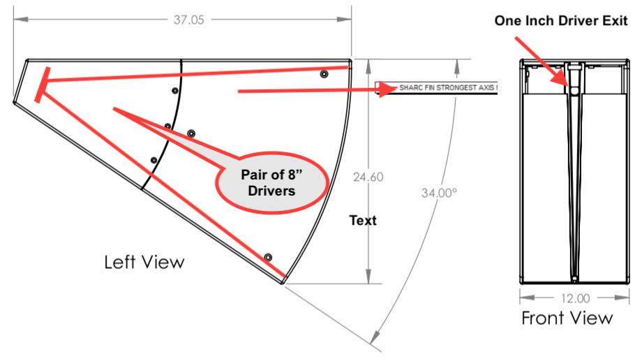

I was told by some DSL folk, that a big piece of the Sharc Fin's design inspiration is from Keeles' CBT.
Mark,
The “Sharc Fin” SF1 narrow circular-arc diffraction slot is functionally similar to a circular-arc CBT (Constant Beamwidth Transducer) line array using multiple small drivers of similar diameter to the slot’s average width.
The smaller width of the lower portion of the circular-arc SF1 slot reduces the output of it's single high frequency driver similar to the approximation of the “Legendre Shading” level attenuation a CBT line array uses on it’s outer drivers.
The coverage angle (6-dB-down beamwidth) of a CBT line array with full continuous non-truncated shading (essentially turning the farthest-most outside drivers off) is approximately 64% of the wedge or circular-arc angle. Reducing the shading attenuation increases the coverage angle.

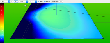

The SF1 appears to have around a 30 degree circular-arc horn angle. The SF1’s “Asymmetric Vertical Dispersion” is in turn described as a 60 degree vertical coverage.
Of course, as Ivan Beaver (of DSL) would ask, “ 60 degree at what frequency?”, it takes a bit of work to discover what the polar response of the SF1 is, the example given in post #11 is just for the two-octave range centered at 3.15kHz 😉.

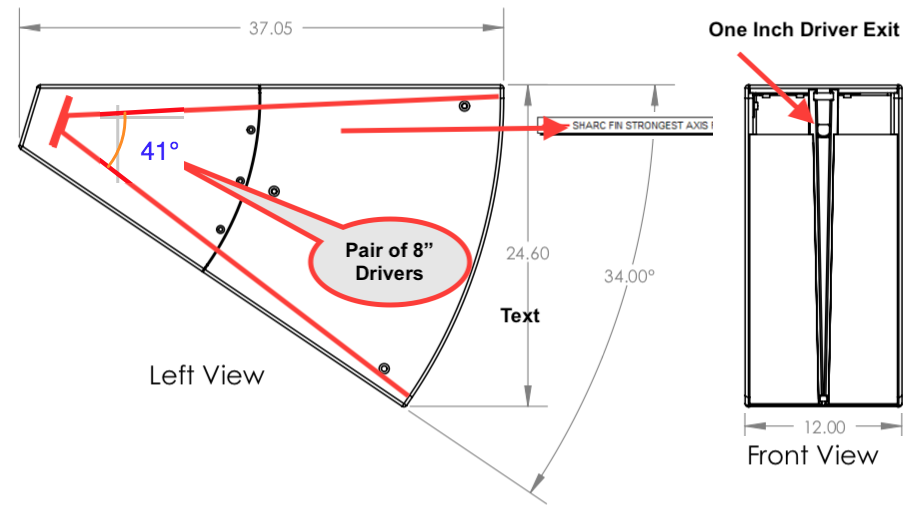

Hi Art, all you say makes sense and expands my (more meage) understandings.
The line drawings show 34 degrees...good estimation 🙂
I heard one and walked around the floor at bit, it does a nice job at even sound side-to-side and front-to-back....... "acoustic Legendre slot shading" works.🙂
Classrooms, lunchrooms, ... etc ....it hits bingo for that kind of use, imo.
Ha, used to be able to read a protractor in the classroom..
My 30 degree estimation was backwards, the outside of the box is 34 degrees, the angle between the upper and lower horn walls is probably around 40-41 degrees, vertical diffraction "spill" bringing it out to 60 nominal 😉
