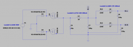

And power supply.
Since this was my first design, there are some aspects of the power supply that are a bit...unconventional. Rectifier is a hybrid diode-tube full-wave bridge using the U18/20 4V rectifier. There is also a combo rectifier socket - it can use 5Z3 as well. It is a CLCLC supply using 27H of Lundahl chokes per channel. The unconventional aspect is the driver stage is the first tap in the supply given the higher B+ requirement of the CCS load. A somewhat significant amount of internal restisance was added (1.6K per channel) to drop the voltage for the 6A5G B+, which has been split into two separate rails. The sound is very good, so the added resistance doesn't seem to have had a deleterious effect.
