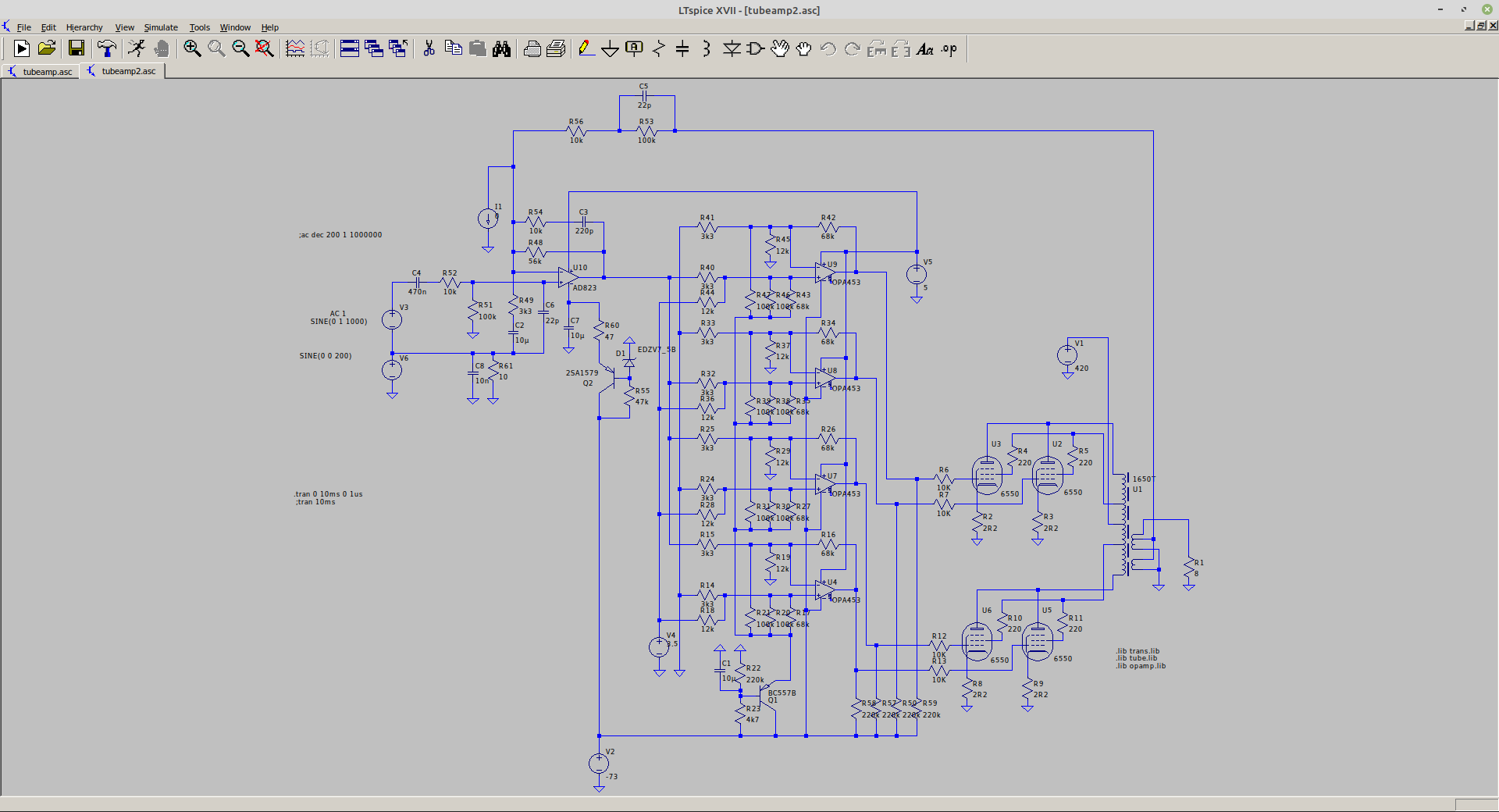

Here's one I built from a couple of years ago. The bias for each valve is set with a PIC and a DAC08. The PIC measures the current in each cathode resistor during calibration.
