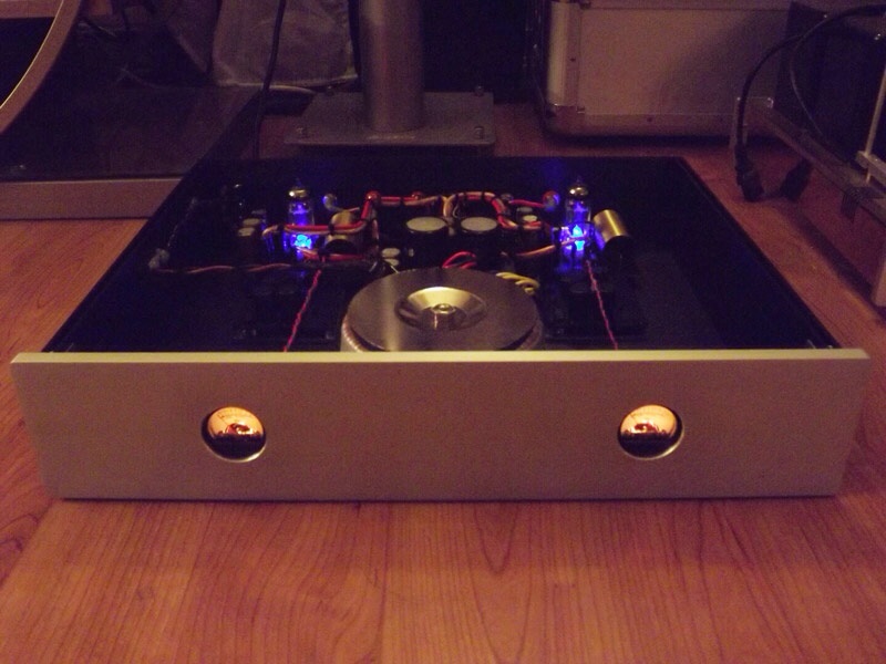

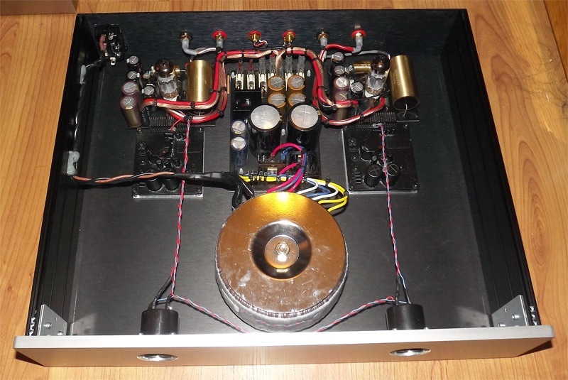

I do not know if this is hybrid enough.
The tube replaces the input opamp from the class D board.
ECC99 srpp pre with Class D 400Watt end.

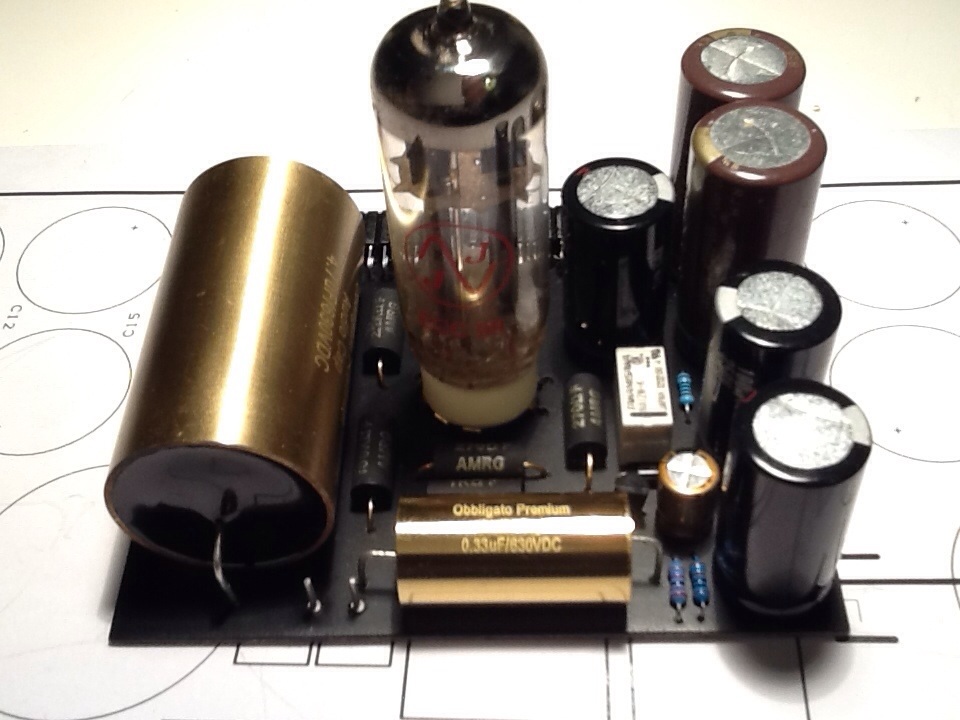

Another picture.
The tube makes the class D amp just sound right for me.
Without the tube, this class D amp sounds to sharp for me. With the tube it sounds rounder at the hights.

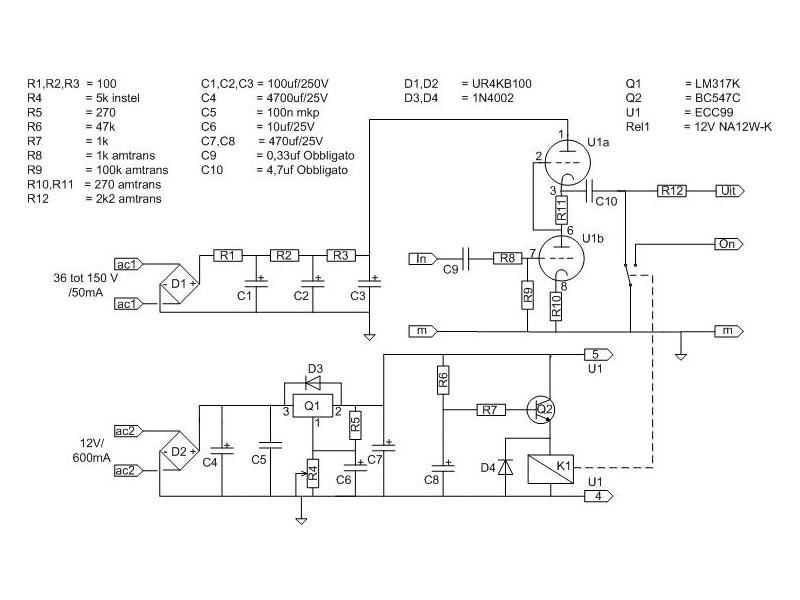

Joined 2009
Schematic of the tube part. After that use Hypex UCD with the input opamp bypassed.
