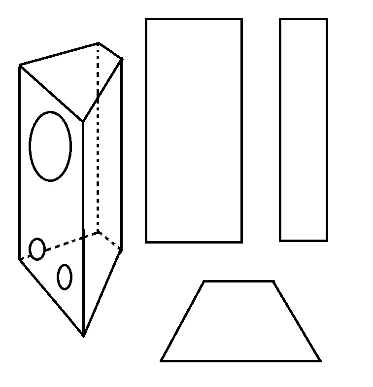

shape of the bass reflex box
And another if the walls are brought in about 0.7 degrees each.

I am forced to discard the golden ratio because it would result in too large an envelope. since the diameter of the woofer measures 38 cm I get a width of at least 40 cm and consequently a depth of 64 cm.
so I have to fold over a width of 40 cm and a depth of 50 cm with a difference of 10 cm per side.
In your opinion, rather than making the sloping walls, it could be a valid alternative to make the internal rear surface as per the attached images?.
