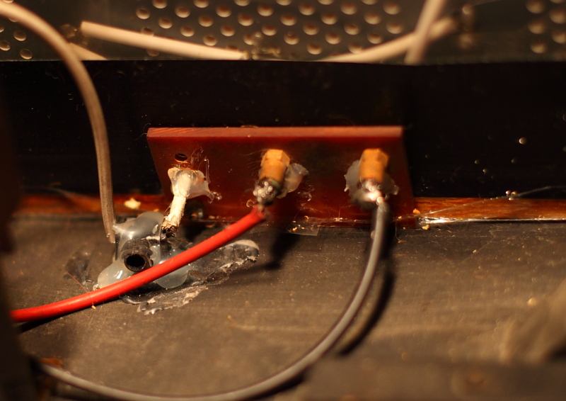

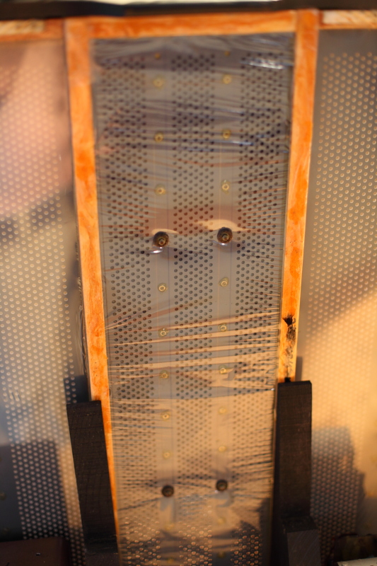

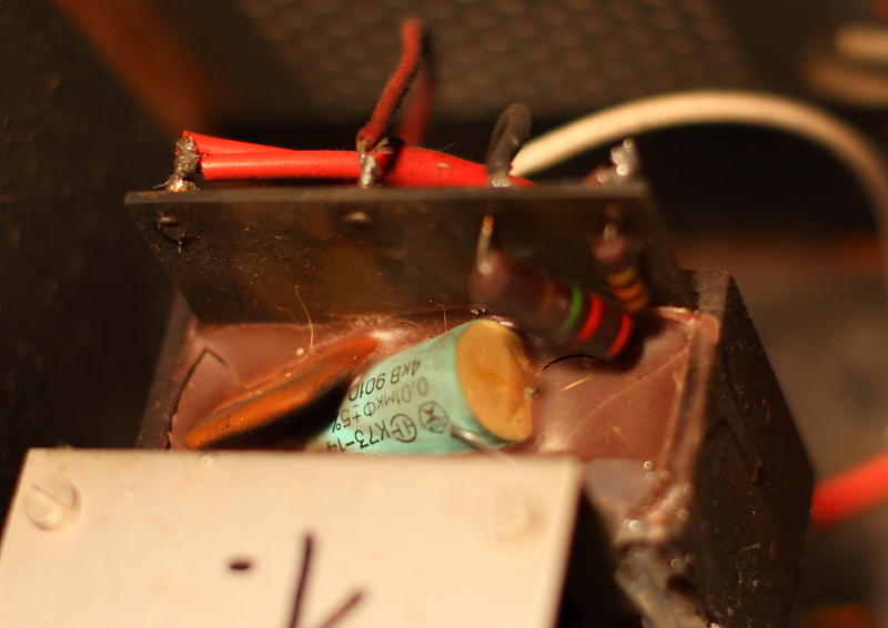

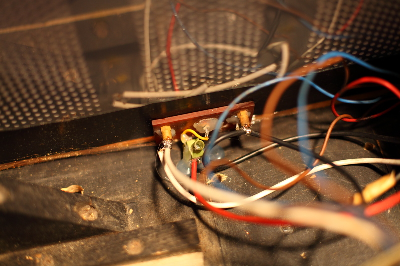

These are pictures from a pair of Quad ESL that have been refurbished by Reiner Romer. According to the owner he had to wait one year to get his speakers back. They worked for a while then they started to make humming, buzzing and rattling sounds. I let the pictures speak for themselves.
I have seen that two pictures are missing in this link (especially the one where the diaphragm is stretched with the help of a spring balance). See attachment.
Working with 3 micron film is tricky. Try these clamps. They are looking slightly different than the European ones, but should be the same.

Hi Harry
When stretching using the spring ballance, what pulle do you aim fore?
I guess it depends on the film thickness but say for either 3 or 6 mu film ...
Yes, it depends on the thickness of the film. The thinner the film, the more tension you will need. Using the spring balance, 2.5 kg is a good starting point. Don't use more, because the film will rip easily. Better to go around a few times until really ALL the tapes have the same tension (because when tensioning one tape, the ones next to it will relax a bit).
