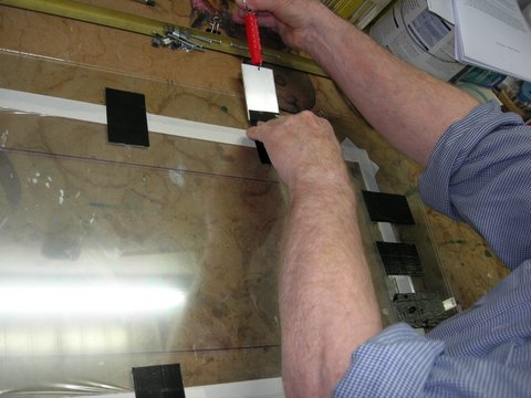

What system did you use to tension your Quad ESL 63 diaphrams?
I've rebuilt Quad ESL 63 diaphrams in the past using a stretcher-type jig - what I found was that the diaphrams lost tension after about 1 year resulting in the oscillating diaphram (motorboating).
From my understanding, Quad thermoset their diaphrams (ie. part of the process of tensioning the diaphram involved heating it) and I suspect this prevents the diaphrams from losing tension.
I have a stretching jig similar to the one from Quad (including an oven for the heat treatment). See attachment.
If the panel was stable for a year and it lost the tension after this time, then something is wrong. With Mylar C or Hostaphan RE, there shouldn't be such a problem.
Every panel will lose some tension in the first weeks, but then it should be stable. This loss is higher when the diaphragm is only mechanically stretched. A diaphragm which gets a mechanical and thermal treatment at the same time will lose not so much tension. But it will. Also Quad did slightly overstrech their diaphragms to compensate this loss. So the Quad technique is not there to prevent the diaphragms from losing tension, it's for sound reasons.

Hi Harry,
That's a beautiful diaphragm stretcher. Do you heat treat and stretch at the same time or mechanically stretch and then heat treat in the oven afterward? (I'm trying without success to imagine inserting your stretcher into an oven.)

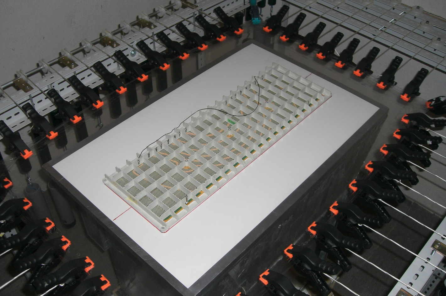

Where did you get the clamps to hold the film - I've experimented with clamps and 3 micron film, however, the film slipped through the jaws of the clamps.
It seems that weights/gravity with the constant tension on the diaphram is the way to go - the "frame type" jigs with wing nuts for tightening seem to be a compromise (from my experiments).

Hi Harry,
Thank you.
First I stretch the diaphragm in the jig and then afterwards it gets the heat treatment. But during the treatment the weights are always pulling. So it's a mixture of mechanical and thermal treatment at the same time.
Please stop imagining.🙂 Yes, it is not possible to put a 2 meter long stretcher into an oven.
BTW I have never liked to do it that way.
Harry

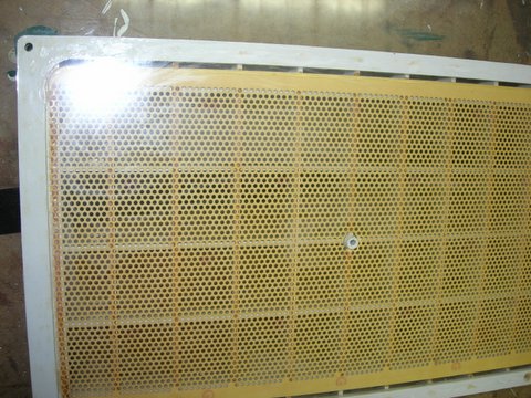

now I can pursue rebuilding my Quad ESL 63's via the DIY route.
I would also recommend the Esl-63 kit from Rob Mackinlay. Much easier to do it that way. Especially for beginners.
Here a link to someone who has used this kit successful for repairing (the original link is down, but I have found it in the Wayback Archive).
Harry
I have seen that two pictures are missing in this link (especially the one where the diaphragm is stretched with the help of a spring balance). See attachment.
Working with 3 micron film is tricky. Try these clamps. They are looking slightly different than the European ones, but should be the same.
