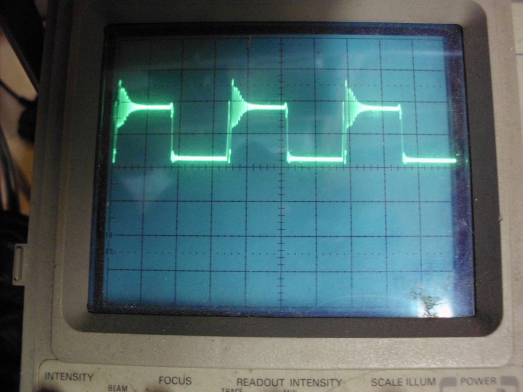

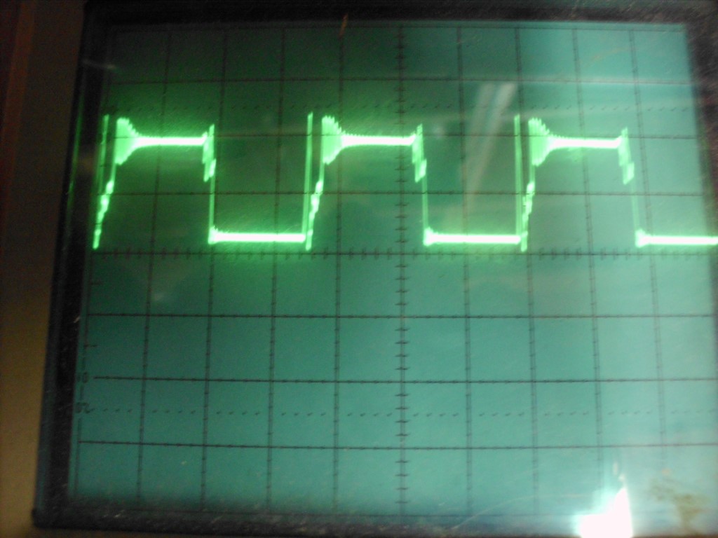

All pics with ~75w load. Scope probe on outer primary leg.
Pic 1: ~10v input. Mosfets cool.
Pic 2: ~13v input. Regulator starting to reduce PWM. Minimal heating of mosfets.
Pic 3: ~15v input. PWM reduced further. Mosfets hot.

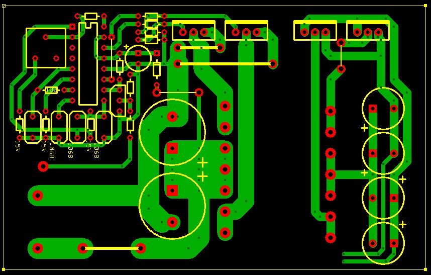

lazzer, your pcb layout needs to be improved wrt the fet drive loop and where the IC gnd connects to the main power ground. The fet gate drive current loop needs to be a minimum loop path, not a large loop path that includes the main switchmode current paths. The IC should gets its reference voltage gnd, and fet drive gnd from the a star point that also stars to the main filter caps (ie. over near the FET sources.
What frequency are you switching at? You may want to also add some smt ceramics on the rear of the pcb to provide minimised loops for the higher frequency components of the waveforms.
Are your measured results from that pcb, or a birdsnest?

Before you go any further, read Jim Williams application note AN118 on high voltage SMPS;
http://cds.linear.com/docs/en/application-note/an118fa.pdf SMPS design is not trivial, and secondary voltages which you seek require a belt and suspenders approach to transformer wire insulation and insulation between layers.
You're going to blow the trace between the sources of the MOSFETs shown on your PCB. Don't be afraid of using both sides of the PCB, but try to keep the high current traces continuous, i.e. without via's -- you can easily route the gate drive resistors such that they jump the high current traces.

I'm testing the circuit on a PCB. I'll re-arrange things and see if it helps. My gate waveform looks decent with fast rise and fall times with slight ringing after turn on. It works great when PWM is full (~49%) but as soon as it reduces the width it gets hot.

The yellow line between sources? It's a jumper. PCB is single-sided to make prototyping easier. The large traces are covered in a thick layer of solder. PCB stays cool. Probing along the ground trace shows minimal noise through trace.

Efficiency is based around understanding where the losses are, and routing circuits so that important parasitics are managed.
It is important to have a design prepared, where all operating parameters (at idle and max power) are identified, including peak current levels and voltage drops and power dissipations, and relating them to the parts choice and the transformer design. If people can't review that design detail, then it pushes the design role on to others wrt part selection, such as your diode selection query, and raises so many question marks as to whether basic parts such as the transformer have a suitable design. Everything in a switchmode tends to interact, so all design aspects need to be looked at in order to get a feel of assurance.
Poor parasitic management shows up in your waveforms, which is why I looked at your pcb grounding scheme. PCBs can have long drive traces weaving all over the place if the basics of star grounding are understood with respect to where all the switching currents are flying around in different loops.
A photo of your measurement technique for the CRO photos is also worthwhile, as the use of anything but short ground stubs as per rf probing techniques can present spurious waveforms at switching transitions that misrepresent what is actually occurring.

My scope probe is a little red probe with a 6" lead coming out of the side of it with an alligator clip I've connected to supply ground at the PCB. It has a 3 position slide switch on the side that effects it's sensitivity.

What photo do you need? My "measurement technique" is clipping on the probe ground and probing the traces. 🙂

Compensation goes to achieving stability across your operating range with the fastest feedback loop transient response - but that is pretty exotic stuff to put in place as it needs a very well known and settled power supply and techniques for measuring phase margin, and helps if you have a simulation set up.

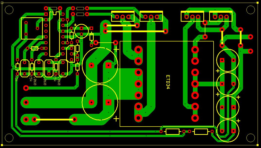

Assuming your transformer wire size and turns design are fine, then interleaving is your first improvement, and should work well - but you need to include adequate working voltage insulation between pri and sec (at least you don't have to worry about serious insulation). Flat multifilar is good, easy to achieve, and probably gives the best coupling and lowest proximity etc losses for a diy.
It doesn't take much of a noise glitch to move reference and IC levels around. With your existing pcb, you could cut the 0V trace that joins the IC circuitry to the input 0V bus trace, and take an underboard link from pin 12 to the common source of the FETs. And take the output 0V to pin 12.
If you can get any surface mount parts (eg. diodes, bypass caps in at least 1812 size), then making a pcb with lands on the rear to mount a few critical parts is a simple and very effective way to significantly reduce current loop areas and get much cleaner switching and regulation. This would especially work for the diode rectifier section.
A probe spring clip (terminology - What is the name of this springy type oscilloscope probe accessory? - Electrical Engineering Stack Exchange) is your best friend for avoiding seeing lots of glitches that aren't actually there.

I'm currently drawing up a second PCB layout to try to improve things.

Good on you lazzer. If you wanted to be pedantic, the 0V trace for all the regulator IC parts should go to pin 12 directly, not the filter cap. The trace between that filter cap and pin 12 has the FET gate drive transient on it, which would couple in to all the IC references. I think recent IC's blank that part of the period out from decision making, but the older IC's wouldn't have.
Are you able to move the transformer closer to the power devices (eg. keep the links on the pad side)? The aim being to reduce any high current switching loop area to a minimum.
I may be able to sneak the grounds up to pin 12 but it might be a squeeze. I'm trying to keep a lot of space in between traces because my friend makes me etching masks out of vinyl. His cutter isn't accurate enough for tiny traces. That's also why it's single layer.
The way this board sits in the chassis requires the heatsink to be placed on the edge of the board. I don't think there's a way to wire the mosfets without jumpers.
Here's an update but I haven't moved the grounds to pin 12. Some of the jumpers like the + supply input and the rectifier outputs have chokes instead. There are no snubbers on the primary. I tried using them on my first board with various values but it didn't help the ringing. I didn't see any large overshooting on the scope and the mosfets are holding up ok. Are snubbers more commonly used on line powered supplies? I don't see them in any of my car amplifiers.

No worries about the pcb layout - my comments were only for information, and to assist understanding - we all have to make compromises 🙂

How about turning the whole transformer 90degrees and having the mosfets on the top like they are now, but put the diodes on the bottom??? Nice and symmetrical - me like...
The power tracks should not get that much longer, but the mosfet drains definitely will get shorter...
I would also move the gate resistors directly at the gates. They can be under the mosfets.
