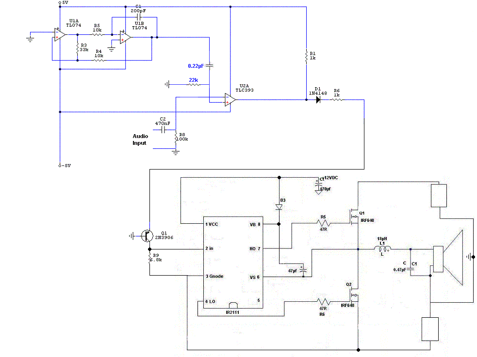

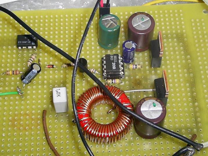

I use IRF640, the coil is a T94-2 with around 45 turns of 0.5mm or something wire on it on it.
The power i dunno.
The power i dunno.
what is the + - Vcc applied?The power i dunno.
by the listening impressions,do u think that it is powerful enough to boom a subwoofer?
have u tried paralleling the mosfets?
the two rectangle boxes,i suppose they are power supply + - V?

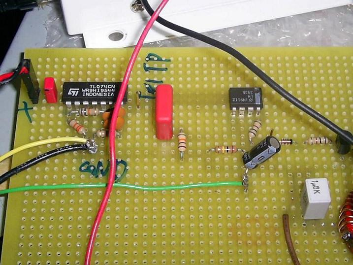

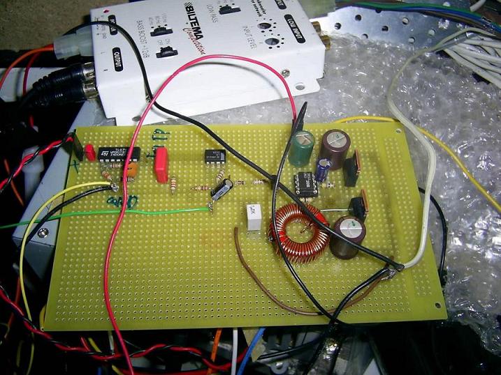

I use 2x19v rails, i have driven my 2ohm subwoofer with it and the drivers bottomed out when playing loud.
One problem with it is that it beeps faintly on a freq that sounds like 2-5khz but that can prolly be fiwed with the output filter and adding of a post filter feedback and error amp.
Tho the beep is not heard with a subwoofer connected.

plz draw the 'proposed cure'' schematic.
can i use IRF540 with this amp of yours?
how high can the +-V go,ie the safe max. with 640 and 540?

You may want to replace the IR2111 with something better, like IR2011 that is designed for class d audio.
For IR2010, IR2110, IR2113, just add a second comparator but wire is opposite to the one in the schem, swap the inputs.

R U sure that the new scheme u post is correct?
BTW have u done it on PCB?
can u post the pics of finished amp.

neat work😎
and that prize of all in a class d amplifier...NO HEATSINK!
i will make a pcb and then go ahead.
i will try replace TLC393 with a opamp comparator.
using two dual opamp chips,2 opamps for the main scheme and one will be wired as a comparator and other as a preamp.
Sagar
thanks for the warning but l i had wired opamp as a comparator before and it worked well.
but as u saying,so i will use 393 family itself
