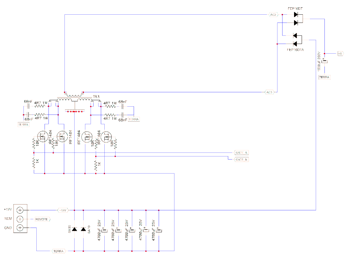

Just checking if anyone knows what i can use for a replacement for a TC4427COA that's marked C2 on a Sundown SFB 8000D?
That driver was too slow in at least one amp. You could try it but something like the UCC27524 may be a better option. The enable terminals are often left unconnected. Wait to see if anyone can answer definitively. You could also try contacting Sundown, although I doubt that they will help.

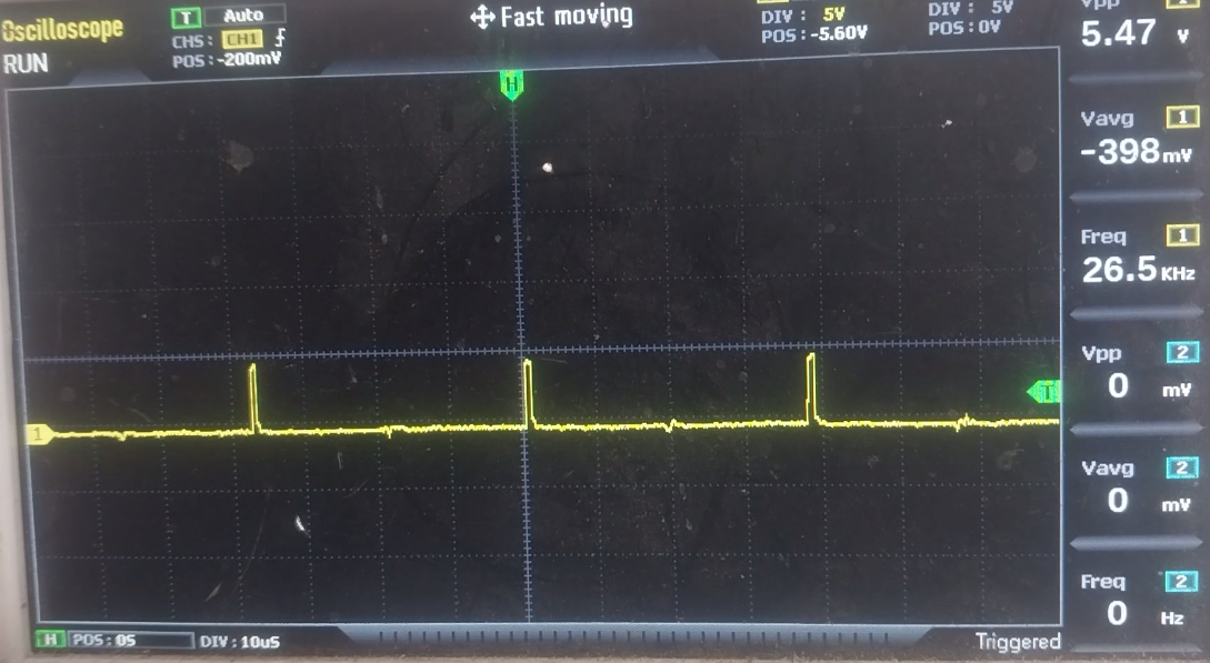

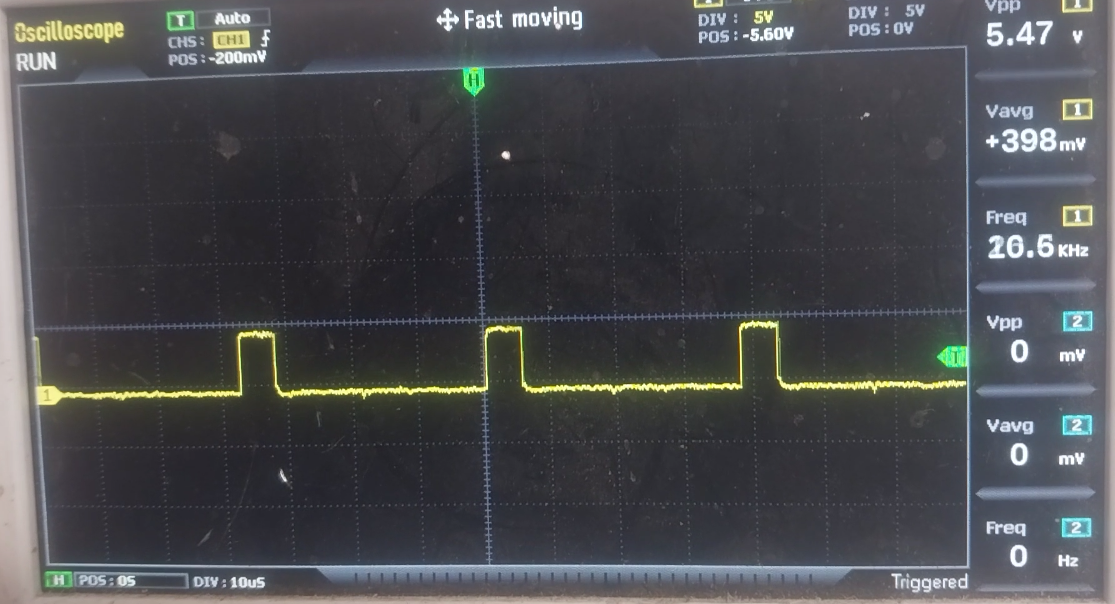

Q: Have you looked at the drive waveforms?
A: There is no waveform on IRS2092STRPBF but there is on the UCC27524.

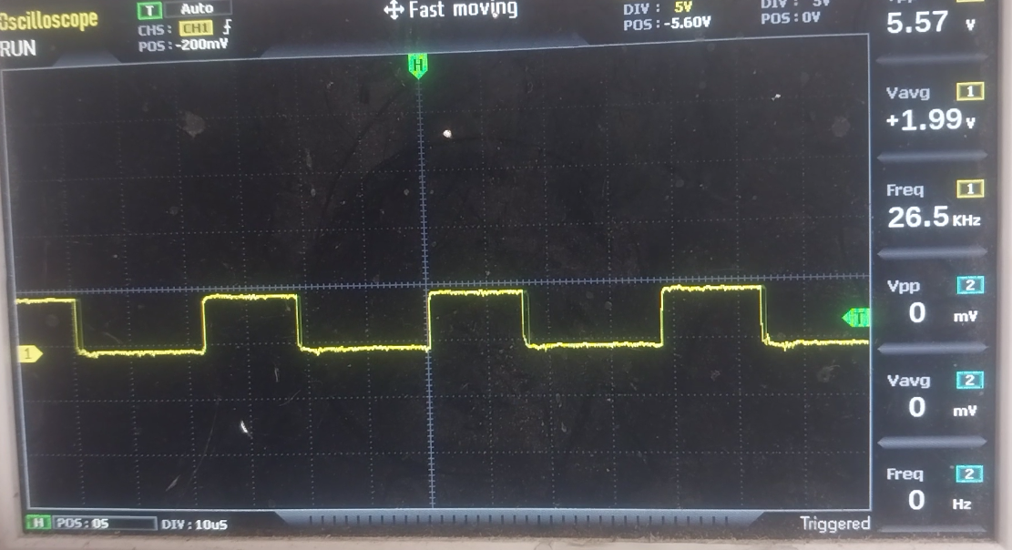

When the current draw decreases to 1.9a, does the duty cycle decrease?

Q: When the current draw decreases to 1.9a, does the duty cycle decrease?
A: No
