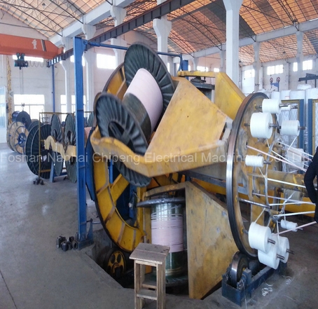

I don't know what it does to the sound but twisting wire with a drill defiantly messes the wire's physical structure. It makes flexible wires stiff. To twist wires you should secure the bundle at one end then twist them by hand starting at the bundled end. I don't know if twist is the right word. You kind of rotate the bundle allowing each wire to find its own lay. As you go allow the free wire ends to "unwind". You also must keep the free ends separated. you can make nice cables that remain flexible and hold their shape naturally with a twist pitch many times that of the bundle diameter. This should satisfy the inductance worrywarts. Secure each end with a cable tie, length of heat shrink or something. This will prevent the wires from unwinding.

Twisting wire with a drill not only wraps the two wires round each other, but also twists the individual wires. This may introduce lattice defects, and hence make the wire less flexible - it becomes work-hardened. It may also slightly raise the electrical resistance, although almost certainly not enough to make any practical difference.
the reels are rotated in the opposite direction to the twisting.
It is the contra-rotation of the wire feeding in that prevents the TWISTING of the strands and their insulation as they "wrap" around each other.
The twisted cable does not have any TWIST in the individual strands.
Using a drill to twist the stands around each other is bad for the metal wire and bad for the insulation and bad for the final product.

Heating the wires with a hair dryer/paint stripper gun softens the insulation and helps with laydown and can eliminate self untwisting.....this is done during twisting and after to cause insulation to settle and set to new position....clamp cable position until fully cooled.
Much less 'overtwisting' is required to arrive at the desired twist rate.
For diy usage, the twisting of the copper is not a huge issue regarding reliability of the cable assembly, and my tips above help to reduce the forces on the copper during twisting.
