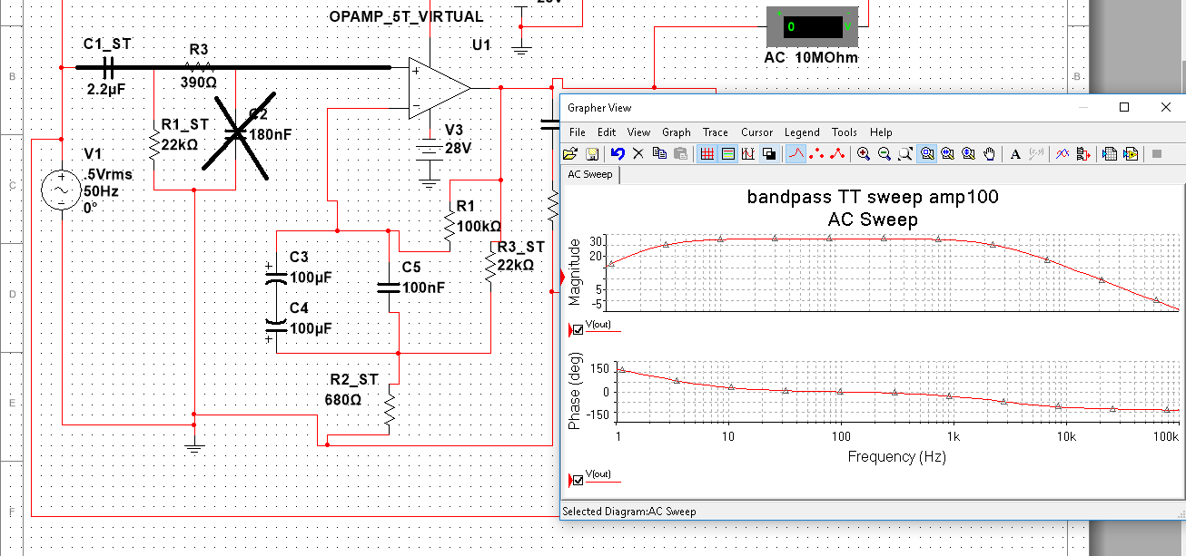

AndrewT: those graphs are to show, how the caps influence the low pass. Should settle for a 220uF or 470 back to back. But for slave to work, they have to be like in the picture above, not between R11 and ground. I removed them all yesterday, now the slave works, but of course can get DC at the input. Works best with shielded cable, shield ground to the xover, and from there to chassis.
this way the caps cause trouble, as they stay charged and pull up pin 2.
in the simulation it does not matter, where the caps are, as per 1st or 2nd image

They are a DC blocking capacitor. They don't have any significant AC voltage across them. Measure an amplifier that is being tested to maximum power. Or predict by simulation.
The DC blocker can be exposed to DC if the amplifier fails and sends the output to either supply rail. In this fault condition you can protect the capacitor from excess DC voltage by placing a signal diode across it, in both directions, i.e. an inverse parallel pair of 1n4148
If you are concerned that these diodes might affect the sound quality of the amplifier you can double them up so that the capacitor has two diodes in series pointing in each direction.
The capacitor in the NFB lower leg can be low voltage typically 6.3V but there are reports that higher voltage here can result in better sound. I suspect these reports are from Builders who have installed a DC blocker that is too small and has significant impedance in the audio band. Fitting a big capacitor removes any effect from the audio band.

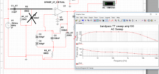

the simulation does not like my plan to put the capacitors the other way around.
edit: thats when the 100k resistor comes in. Now you see it
now you don't

R1, 100k, in the top diagram complicates the NFB. I don't know what that combination is doing.
As you can see the 100uF in series gives the equivalent of 50uF. That cuts off your low bass. Is that what you need?
For the very low DC and very low AC voltages across the DC blocker you don't need a bi-polar capacitor. Polar is good enough, if you have it oriented to suit the quiescent voltage. And then protect it from excessive reverse voltage with a signal diode.
At 35Vdc offset on the output from a failed output stage, the current passing through the diode is 35V/(22k+680r) = 1.54mApk

If I take the 100k ohm out, this happens:
The value of the um 100k ohm resistor seems does not matter

NFB cap >= 0.47uF * 22k * sqrt(2) / 680r >=21.5uF
They meet that requirement for virtually no AC voltage across the NFB cap.

in post 43 the first picture R5 and C6. It looks odd. R11 and R4 set the amplification. R 5 seems does the magic so its not ending up at -130dB.
"R3 (upper NFB) is tapped into the wrong position."
it is there because if it is on top of C5 it seems C3/C4 stay charged and put a voltage onto the inverting input. So when I switch mute off, pin 14 is at some decent negative voltage and I get DC onto the output, in bridge mode. Removing C3,4,5 solved the problem.
Building it like in this imageseems to work in the simulation and actually the 1st version was built that way. And worked without a plop when switching on, in bridge.
They look good because there is no DC at the input or output. You may see more if you remove C1_st from the input as you are now seeing several filters acting together to form the FR.
