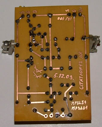

Well on sugestion by Millwood...i built Mosfet citation 12 and was very satisfied. Well my first Mosfet amp ever but good one. Good Job Mr.Pass.
Pcb was made for about half an hour. Everything elese on about 1 hour. and there is the music. I also did destroy one pair of irf540. Maybe beacouse bias tromier pot was old 1o years like all the other components 🙂
