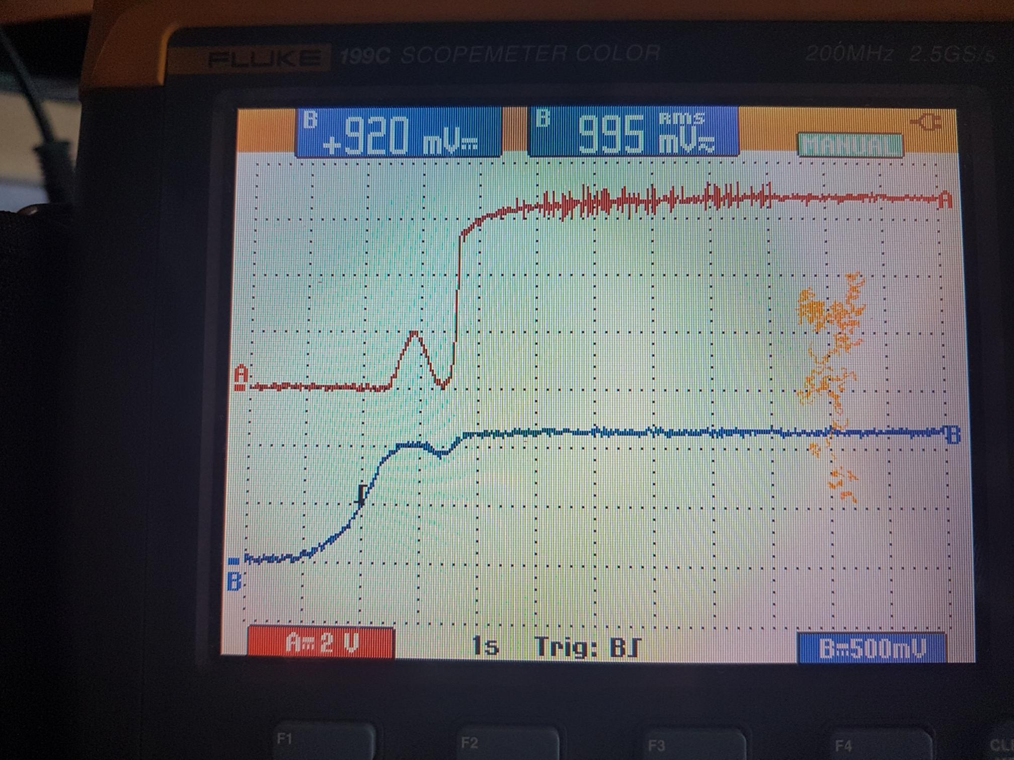

Hi, I accords to you too. I am very happy with the amp. But I have found one problem recently. I changed the 300b from Gold Lion to ELROG 300b. Really I noted all better but here is problem. The filament of one channel light on one second, later power off another second and finally power on (I interchange both tubes and the same resul). Exploring a few (with a scope) I found that optocoupler that set the enable signal of voltage regulator has this behaviour.
Using the original tubes the fact is the same but because filaments are differents is not visible, but I got the same scope capture.
Something knows why this strange behaviour?
This little power off can reduce life time of tubes?
Scope capture shown that (blue trace) led side of opto has a little drop and enable input of MIC29x has one little glitch (red trace)

Hi, same nebulous9 I think that this amp is really great, but this little problem maybe meaninful. I wrote to elekit and they reply me some points to check. Later discard some points, I found that my ecc82 was not totally in good state. When I changed with other, then the problem dissapear. But really this maybe a weak point in the design because one ecc82 not fully in good state (because the bad one mine really sounded very well yet) can lead two starts in the filament of 300bs in few seconds (I saw the same behavior with scope with EML and Gold Lion but it was not not visible because slow start-up, while that Elrogs has filaments light up in one or two seconds and here this problem is visible). I propose to elekit solve this little problem but I do not know if they will do it or not...
