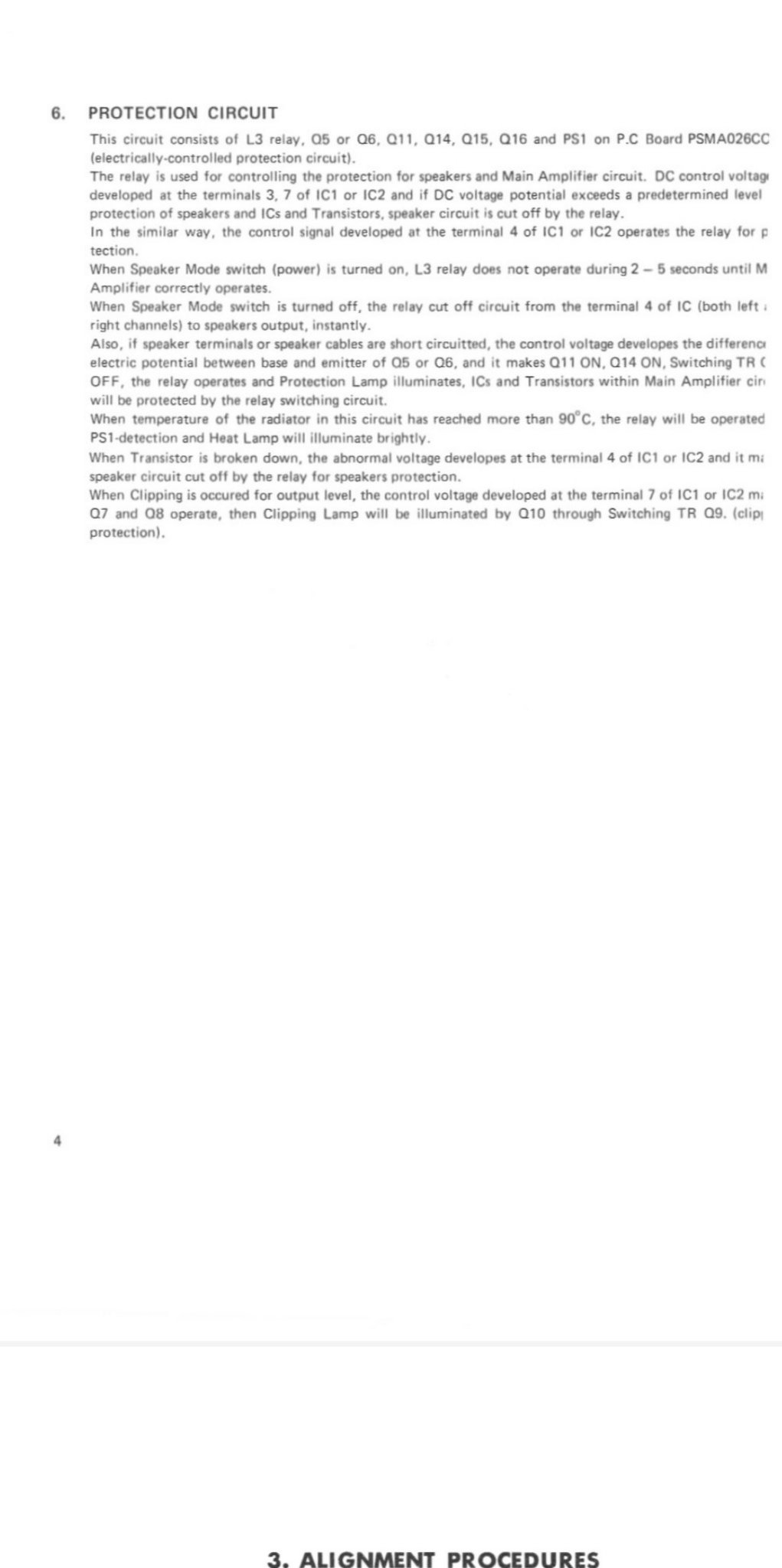

I am not sure whether under normal circumstances (no dc offset detected) transistors Q5 and Q6 should be ON or OFF?

Attached there is a description of protective circuit in Setton RS440 very similar with clipping detection added

I think both Q5 and Q6 are off
The VBE on Q11 is floating, I will replace that transistor and will check again
Any thoughts are much appreciated
Problem solved !
The reason was faulty Q11 leaking current threfore had 2.5V on colector.
I have replaced it with KSA992.
To summarize: on normal operation Q5 and Q6 are off thus Q11 and Q14 are also off so only Q15 Is on.
DC detection activates Q5 or Q6 so they activate Q11 and Q14 which "steals" current from base of Q15.
