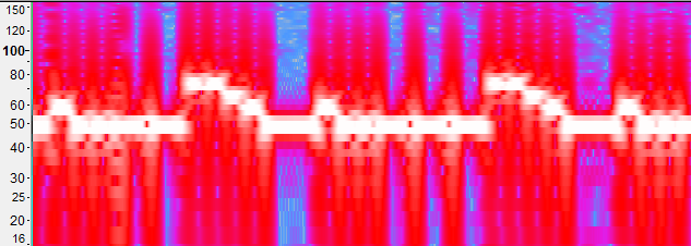

To test subwoofers, i always take this track, it goes lower than most speakers can go. I bring the high res digital file off course (not youtube and not vinyl)
FWIW there is nothing below 48hz in that track, at least in the youtube copy.

in the Youtube copy not, in the version i have on the 1996's cd it's going to about 31Hz (measured myself about 10 years ago) but youtube takes out a lot of the extreme low end in songs with their filters i've noticed. This is also an old track from 1994 (EP release)/1996 (LP release). Modern dub goes lower in some cases, but it's often not on youtube as 95% of that music is never posted online.FWIW there is nothing below 48hz in that track, at least in the youtube copy.
