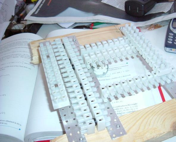

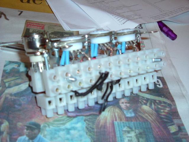

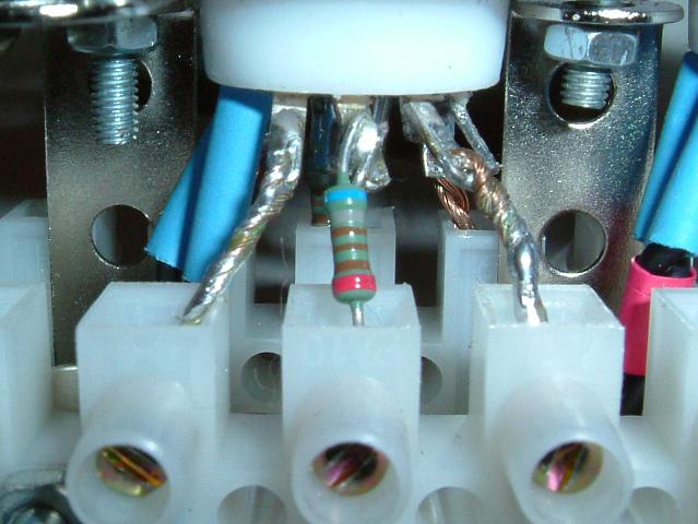

E ErikdeBest Member Joined 2003 2005-11-27 11:08 am #21 2005-11-27 11:08 am #21 under side, where all resistors, caps, B+/-, inputs, outputs can be connected Attachments dscf0117.jpg 51.1 KB · Views: 115 E ErikdeBest Member Joined 2003 2005-11-27 11:10 am #22 2005-11-27 11:10 am #22 Originally for a regulated PS (Frank's one) but can also hold a PP amp with three or four noval tubes. Attachments dscf0118.jpg 51.9 KB · Views: 115 E ErikdeBest Member Joined 2003 2005-11-27 11:11 am #23 2005-11-27 11:11 am #23 Detail of the grid stopper. Nice that most double triodes and EL86 (for the regulator) and EL84 (for the amp) have the same pinout. Attachments dscf0119.jpg 53 KB · Views: 114 Prev 1 2 First Prev 2 of 2 Go to page Go Status Not open for further replies. Share: Facebook X (Twitter) LinkedIn Reddit Pinterest Tumblr WhatsApp Email Link
