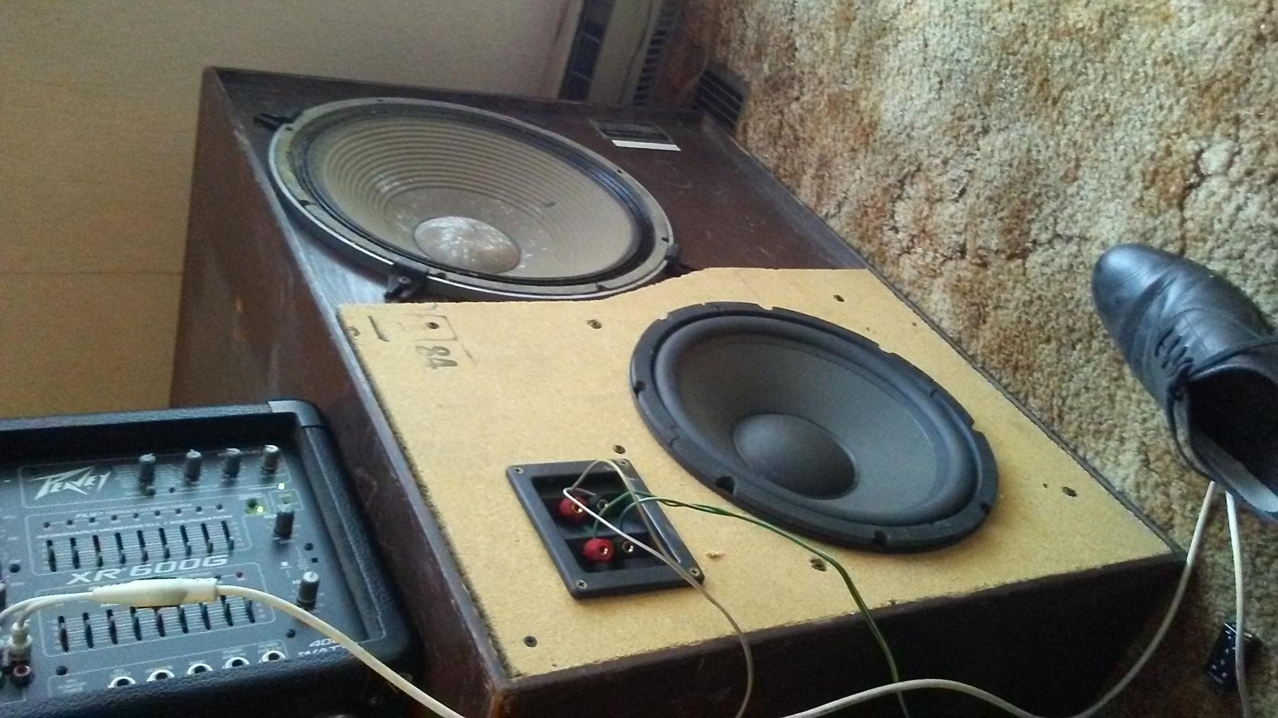

M mashaffer Member Joined 2004 tubiespad.angelfire.com/index.html 2019-02-26 3:59 pm #21 2019-02-26 3:59 pm #21 BTW, I presume that like a ported system one should line but not stuff the box. ••• More options Share M mashaffer Member Joined 2004 tubiespad.angelfire.com/index.html 2019-02-26 10:31 pm #22 2019-02-26 10:31 pm #22 I checked for impedance maxima and minima today and it appears that I am tuned closer to 21 or 22 Hz so need a bit more weight to nail it. Good project for this next weekend (along with the bracing). ••• More options Share Prev 1 2 First Prev 2 of 2 Go to page Go Show hidden low quality content Status This old topic is closed. If you want to reopen this topic, contact a moderator using the "Report Post" button.
