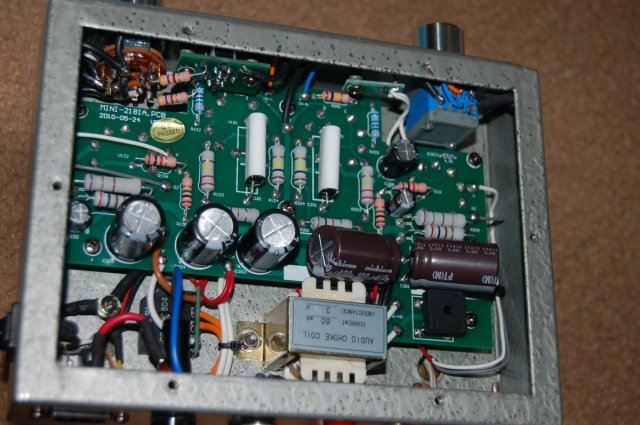

There is the schematic:

It has a little separate headphone amplifier inside, it may not be the same circuit.
There's a version for Europe called Mini84ia which is sold as headphone amplifier and has only a single tap for speakers. It has better headphone output and may use the same circuit for speakers and headphone.

There is one channel with FB and the other no.There is the schematic:
http://www.crystalradio.cn/data/attachment/forum/201404/25/111001zipahdh84rpmxg4m.jpg
Simple as wooden wedges, "typical" chinese.
Probably one erro
So the idea of oscillation can be real

How can you tell that there's negative feedback? Is the cathode bypass capacitor that eliminate negative feedback? Is it because of the value of the capacitor?
There is a link for output to cathode of first stage of 83. In one channelthe cathode bypass capacitor that eliminate negative feedback? Is
I think there is an error because in the other channel doesn’t exist

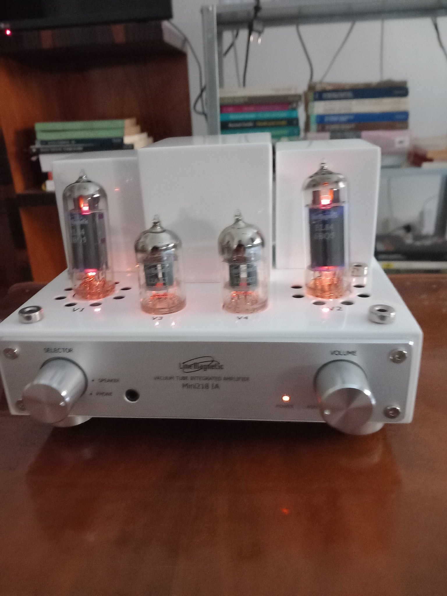

Thanks. The little amp is working faultlessly at the moment with the Triangle speakers they were with for the last months.It may be oscillating , sending more power out at 50khz +. If you have an LED place a 220 ohm resistor on one leg and connect the led and resistor to the speaker. If it lights solid at low volume you're oscillating.
I purchased on a whim a couple of 30 years old Kef only because of their meaured sensitivity of 90 db. The vendor had said they were never used and were in a closet. When they arrived they looked really brand new and there wasn't even a single scratch on the bottom.
When I tested them with the tube amp the power transformer got hotter than usual.
It was suggested here that the crossovers of these Kef are completely gone. I think it is possible. Maybe more so because they were never used.
If the amp does something wrong in the future with the Triangle speakers I'm using now, (those I had been using previously) I will order the led and the resistor and do what you said.
