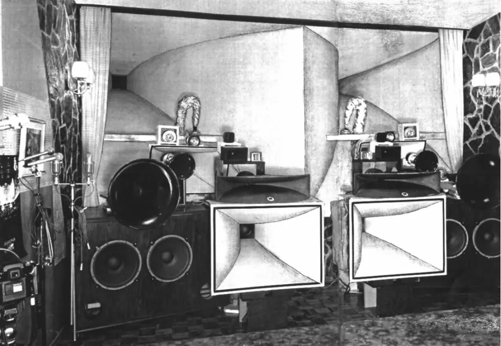

who can upload this images ?This subject interests me as well. I got this from another forum, posted by Angelo in 2008. While not directly about SET amps, I think it is worth sharing:
"Mr. Kei Ikeda has been an enthusiast audiophile since 1919 and his auditorium is a museum devoted to audio.
Look at the two giants horns WE 15 A used in the high bass and low medium range in the main 4 ways system!
The low bass is reproduced by the big woofer you see behind the left shoulder of Mr. Ikeda , another room close to the auditorium is used as a rear load for the woofer . This woofer, IK38 inspired from a RCA duocone loudspeaker, was designed by Kei Ikeda for JVC.
You'll also notice the famous WE 59 A (or WE 540) loudspeaker known as "chinese hat" intended to works with the first Western Electric amplifier, the WE 25A.
Compare the huge mouth of the WE 15A to the smaller WE 6368, half visible behind books and a desk lamp up to the chair in the left part of the view.
Comment: Pictures "ikeda.jpg" and "takashir.jpg" were published in a paper with the title "On ne vit qu'une fois, de musique" in the No1. issue of "Stereoplay" (French edition) in October 1979 . That paper with some others in the same review and the famous papers of Jean Hiraga in "La Nouvelle Revue du Son" from the end of 70's and the beginning of the 80's , led to a deep change in the mind of the French audiophiles.
Shigemi Takashiri plays piano and 10 others instruments. His favorite leisure is to record and reproduce music in his auditorium.
Two Steinway pianos, some Japanese drums and percussion instruments are visible in the auditorium but the loudspeakers are difficult to locate through the collection of lamps and crockeries.
The Goto tweeters are at the same level as the ears of Mr Takashiri. Those tweeters are touching the high medium and low medium Goto horns, the throats of which go across the rear wall, the Goto compression loudspeakers situated in a small room behind.
But where are the bass loudspeakers? Look at the ceiling and you will see the two giant mouths of the concrete bass horns the cut-off of which is 20Hz.
Not visible are the turntable with 6 tonearms, the 6 tape recorders and the rest of the electronics.
There are two 5-way loudspeakers systems in the auditorium of Dr. Idemiya Yoshikatsu .
The two sytems share the concrete bass horns each of which works with two woofers, Goto SG 38 W.
The first system uses:
In the low midrange, MB-90II horn with an YL D-7500 (Yoshimura Laboratory) compression driver.
In the high midrange S-300A (Goto) horn with a SG-555PS (Goto) compression driver.
In the low part of the high frequency range the S-500 (Goto) horn works with the SG-370 Goto compression driver and in the upper part there is a tweeter SG-17T (Goto).
The second loudspeaker system uses:
-In the low mids the JBL PRO 2202.
-In the high mids the JBL PRO 2440 with a 2355 horn.
-In the highs the JBL 2420 with an home-made horn and.
-In the upper range the tweeter JBL 2405.
5-way loudspeaker of M. Tatsuo Kobayashi.
f < 150 Hz : 2 x 416 8A loaded by a concrete bass horn,
150 Hz < f < 650 Hz: compression driver Onken ES 255 Esprit with a concrete bass horn,
650 Hz < f < 2800 Hz: compression driver Onken 500MT with a wooden multicellular horn,
2800 Hz < f < 8000 Hz: compression driver Onken OM 455 with a multicellular horn SC 500 Wood, f > 8000Hz tweeter Onken 5000T.
Comment: That system has inspired the French society: AII Ingenierie SA in building their reference sytem in their auditorium in Chatou (near Paris). AII Ingenierie SA designed the Eurythmie 33 and Eurythmie 11 (the last one is also sold under the label Jadis)."
