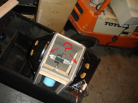

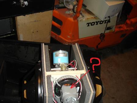

ServoDrive Subwoofer??!?
No - that is the other kind of servo. Rythmik have servo subs, both DIY and fully assembled.
In this thread, servo refers to the driver motor based on a voice coil being replaced with servo motors attached to the cone with the motor coupled to the cones via belts.
Exactly.
