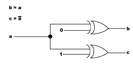

Yes the phase reversal is accomplished by the 74HC86 by inverting the data. This works well for two's complement data except for the least significant bit. It could also be done with a 74HC(U)04 or by taking the Q Bar output of the Data of my asynchronous reclocker (MC74VHC74)

The DAC feeded with inverted data has the inverted audio output. I am using it in my KWAK-DAC.😉

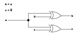

I have looked up the truth table for the EXCLUSIVE-OR GATE and constructed a table for this system(see pic below). It does indeed appeared that the SN54HC86 is taking all the data and just inverting it before it reaches the Data pin of the lower DAC( - ). I can only conclued that the reason this was done instead of just using a not gate was to keep the timing on all 3 pins synchronized.
