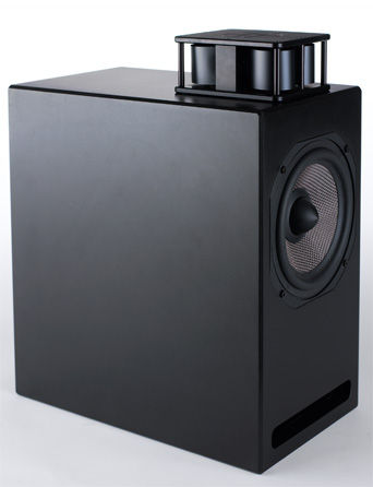

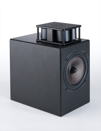

Take a look at this speaker - the base units that match them are on a different page. Use the Heil AMT in place of their tweeter and it could be a winner. I was able to listen to a set of the Pyra Bella 7's and they are a very good speaker! They were paired with a separate pair of stereo sub-woofers for the bottom end.
Bella 7 - Products - High Emotion Audio
Wow that looks interesting. What kind of speaker they use for the mid-range do you think to use? Victor
Welllllll - it looks like this one https://www.madisound.com/store/product_info.php?cPath=45_228_256&products_id=8766
But I would take that with a grain of salt. The tweeters that High Emotion Audio uses are very efficient - they say on the order of 104 db and matching those up to a 88db woofer I would think cause some serious mismatching that would need to be addressed in the crossover (to bring the sensitivity of the tweeter down). I would go for a pro-sound 6.5 inch driver like this one B&C SPEAKERS

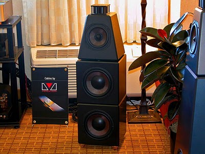

BTW - here is what the entire system looks like - plus HEA uses their own designed crossover for a couple of more grand. Totaled up two sets of speakers plus the crossover go for around $14K.
Credit for the photo goes to Wizard at http://cybwiz.blogspot.com/2010/11/high-emotion-audio-at-rmaf-2010.html
