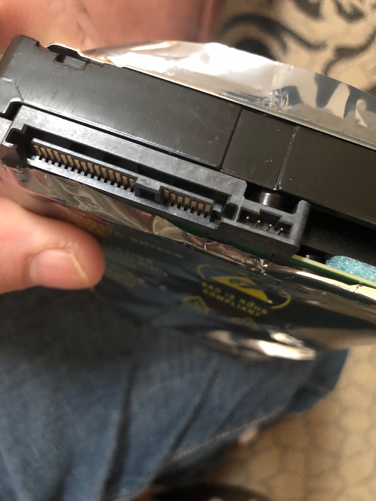

Are you sure they are SATA? Typically server HDDs are SAS which has a very similar connector to SATA but very different protocol. But SATA for servers is OK too, so could be really SATA. Though I have not seen any SATA HP-branded HDDs, only SAS.

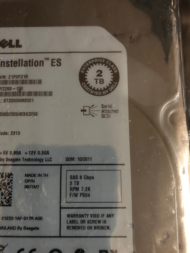

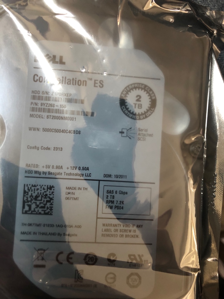

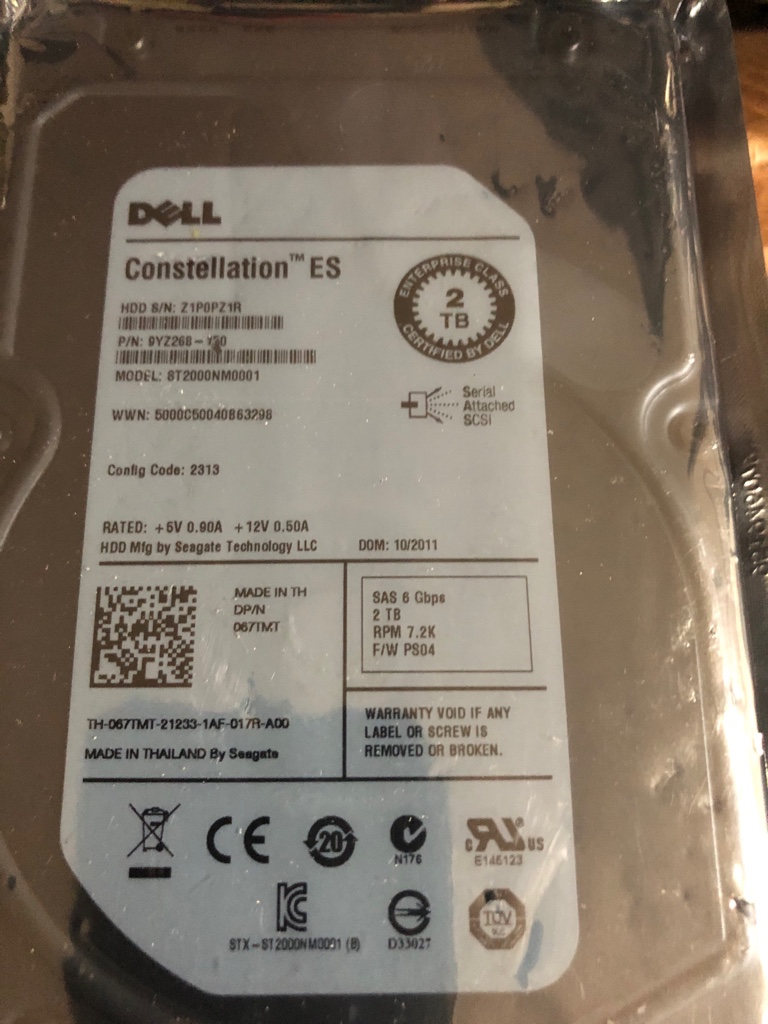

This is what I’ve found out, and yes a newer pc can use this drive
Serial-Attached SCSI (SAS) interface disk drives
Here’s a pic of one of the 2tb drives. I have over 50 of these and will sell them cheap
The plug or jack looks like a sata or have I been out of building pc’s for so long that I’ve forgot what they look like. Lol. Which is very possible. Lol
Well I just found a old drive and your right, it’s not a sata jack. I’m so stupid.
