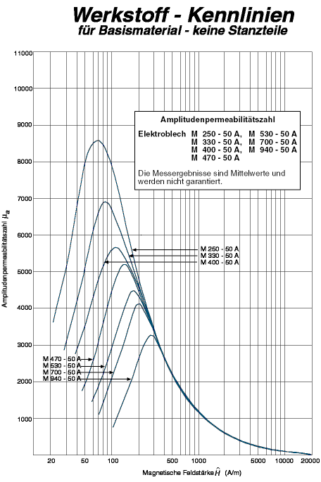

Hello,
every lamination has a strong nonlinear permeability value versus
magnetization for example:
100 Gauss 760u
1000 Gauss 2400u
10000 Gauss 2700u
16000 Gauss 5000u
So when You like to measure the inductance which the main "sees" You cannot measure with small voltage levels as you do!
Probably Your transformers don`t used equal core materials, which are with strong magnetization much more similar then with
the small (measuring) magnetization.
You can try to take out the laminations from both transformers
and put one half from transformer A to transformer B and one half from B to A
Regards
Heinz

Yes, someone at rec.audio.tubes suggested the same thing, the cores being non-linear respect to the test signal's power level. He said the fact that both transformers draw the same mains current when unloaded is an indication nothing is basically wrong. Well, I guess I'll just leave them be, after I do a test running them overnight unloaded to see if any gets warm or fries itself.

I believe the variations in initial permeability explain all of this.... thanks to powerbecker.
