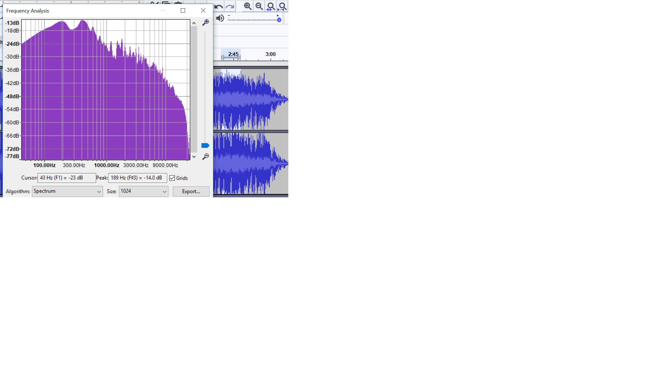

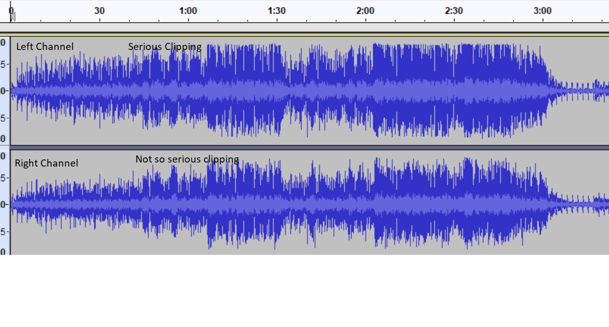

I built the Oatley K303 RIAA preamp some time ago. It works very well BUT
both channel have some clipping, the left more so. I tried a few MM cartridges
with the same results. I'm thinking that R1 (47k) might not be ideal on the left channel, but works better on the right channel. I added a screen shot of the waveforms. Any suggestions would be very helpful.

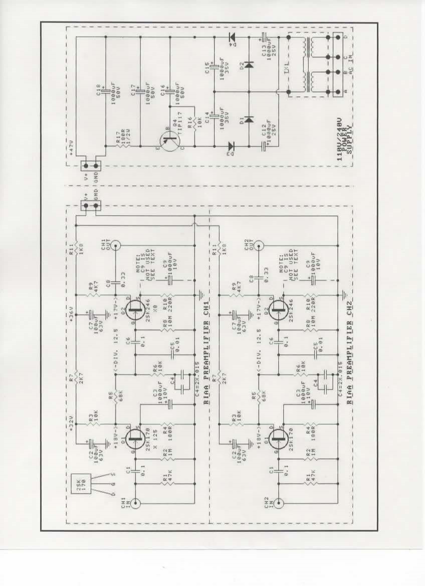

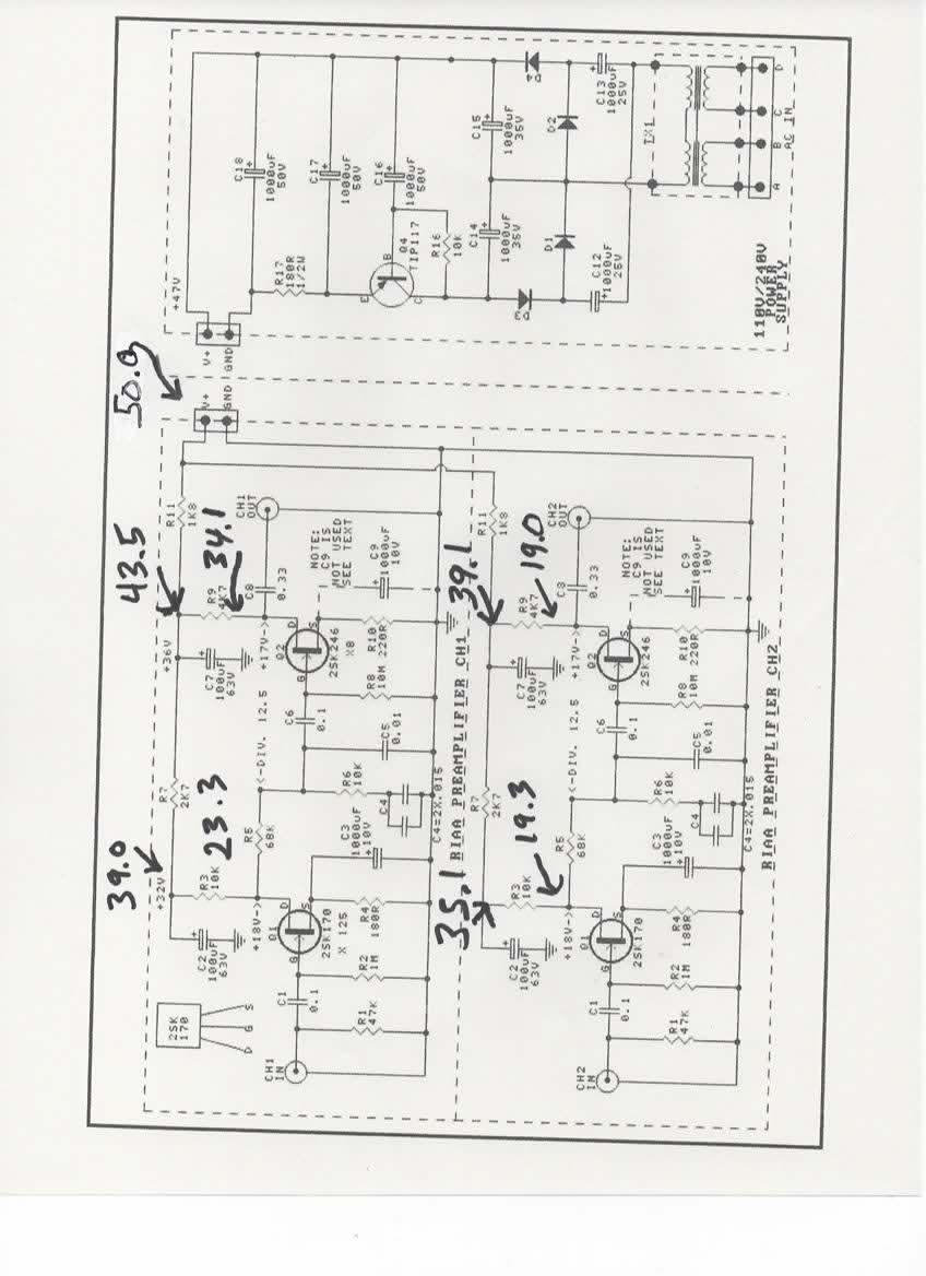

The schematic has 32V supply on the first stage and 18V on the drain for 1.4mA current in the first FET. With 100 Ohms in the source you should see ~140mV. You should check the bias levels to make sure that the FET's are not fakes. With the values on the schematic you should get way over line level before clipping.
The input seems to be designed for GR selection 2SK170 fets and seems about right
The output is designed for GR 2SK246 fets and it looks like you have a "Y" in CH1.
Still there is plenty of voltage swing available.
Running 50V electrolytics at 50V or more is not a good idea
For the spectrum, I meant analyse L and R separately
