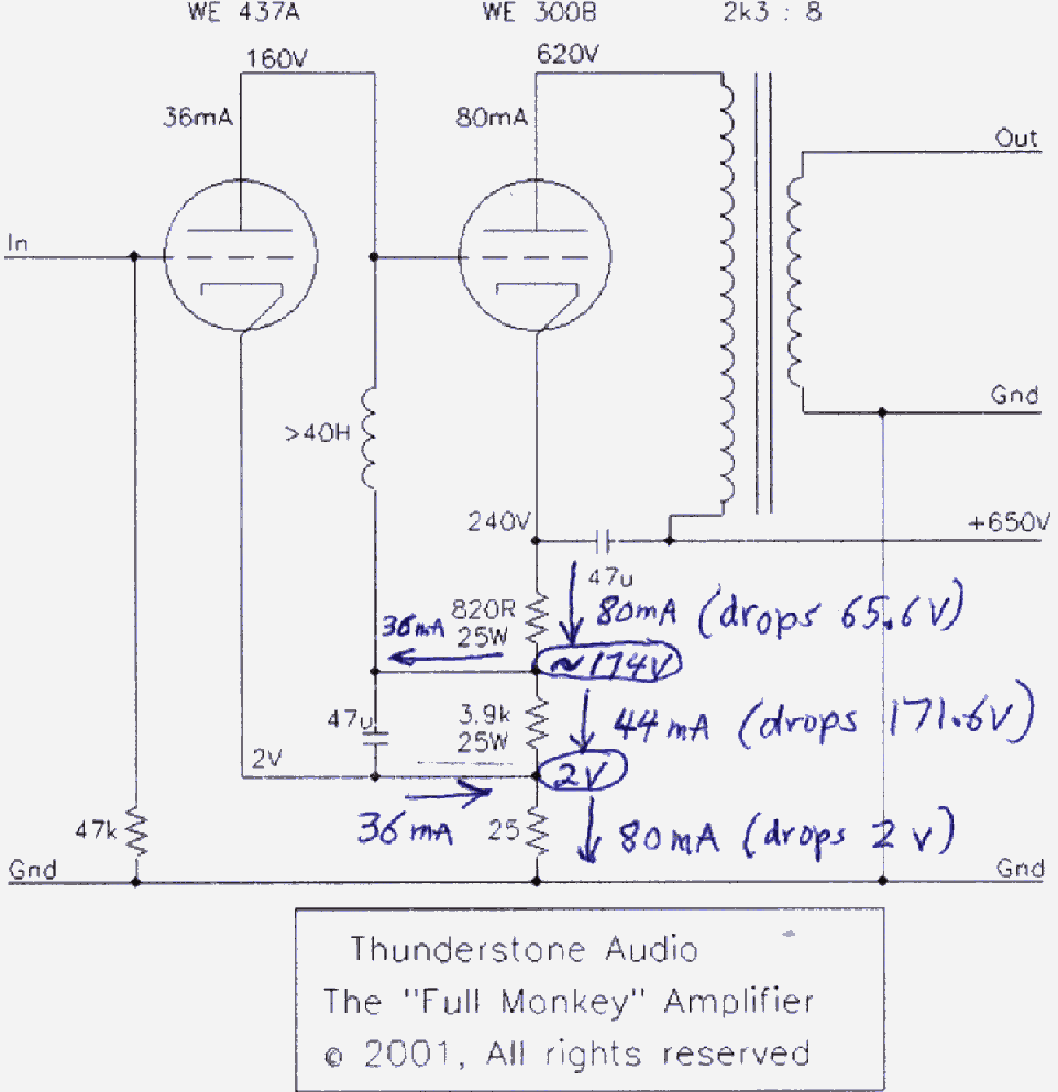

I have been attempting to adapt a design by Thorsten Loesch called the "Full Monkey Amplifier" to use a 5687 and a 12B4A instead of a WE 437A and a 300B. Trying to figure out the values for the biasing resistors is turning my brain to tapioca. The problem is that the old argument about which direction current flows very much comes into play in this topology. I have tried to find the diagram of the amplifier that I came across while doing research on calculating ultrapath capacitor values but I have been unable to find it again or find it by googling for it. Basically the voltage values given at different points in the circuit seem to contradict Ohm's Law. I can think of only three possibilities of why this is: 1) I am wrong. 2) Thorsten is wrong. 3) Thorsten muddied the water for his own reasons. I suspect that #1 is a winner in this case. If anyone has a image of the circuit that they could post, it would be greatly appreciated. Otherwise someone gracious enough to help me will not have anything to refer to. Many thanks in advance for any help.

Ha! Found it!:
G said:
I invite the members here to check the listed voltages and see if it makes sense to them.
It does make perfect sense. There is about 15 V drop on the choke. Think currents. Total current (80mA) passes through the transformer , 300B and 820 Ohm (voltage drops by 65V from 240 = 175V at the top of 3K9 resistor) - after that it is split two ways: 36 mA goes through the choke and 437A, the rest (44mA) - through 3K9. Both currents combine at 25 Ohm resistor, where 80 mA creates 2V drop.

Thanks for the reply. I just needed to simplify the circuit one more step to see it. I will draw up the circuit using the 5687 and 12B4A and post it tommorrow or the next day. Just to make sure I got it right.

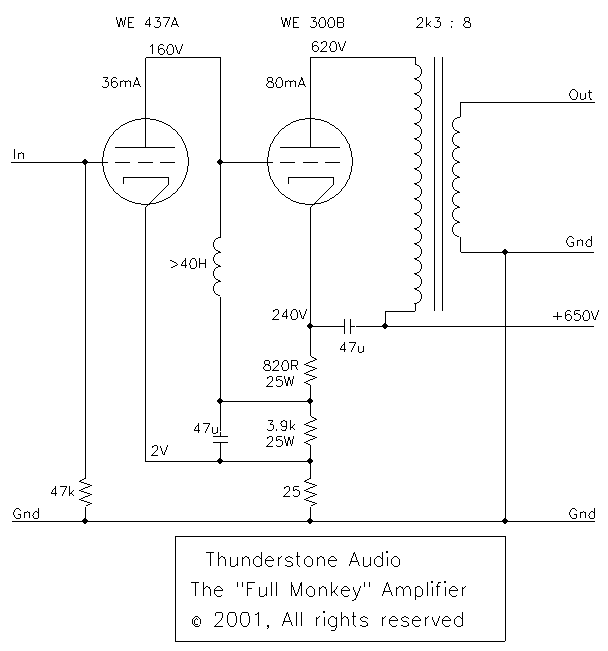

This design makes since if you think of the DC and AC conditions seperately. I am at work now, so I have no ability to post diagrams but you can draw your own. It is often easier with circuits like this to draw two diagrams. one for DC, and one for AC. All capacitors are assumed to be a short circuit for AC. It is often easiest just to assume that the DC conditions are magically satisfied and ignore them for the AC case. The power supply is also assumed to be a short for AC. To analyze the DC path, ignore (they are open) all capacitors, they (ideally) don't exist for DC.
note:
I have developed the lazy attitude that current flows in the direction that makes the particular circuit easiest to understand. It makes no difference as long as you are consistent within a given circuit. I guess that I have lived in the SS world too long.
For the AC case, this amp looks like any other two stage amp. The 820 ohm is the cathode bias resistor for the output tube. The 25 ohm is the cathode bias resistor for the input tube. Ignore the 3.9 K resistor for the AC case, it is bypassed and can be considered part of the power supply. Because this amp has a unique "power supply" arangement no coupling cap is needed. Both tubes are wired in an "ultrapath" arangement which means that the 47 uF caps are in the signal path and must be of high quality, think motor run caps.
The DC case is a bit unique. Both tubes are wired in series across a high voltage power supply. This is done to eliminate the coupling cap. There are two large caps (the ultrapath caps) in the signal path, but these are present in a "normal" design anyway. Mr Kirchoff proposed that all current paths in a series circuit MUST pass identical currents. Actually it is the SAME current since there is only one entry point and one exit point to a series circuit. No one has yet to prove Kirchoff wrong. Now if we want to wire two devices in series that inherently want to draw different amounts of current (a big tube and a small tube) we must provide a path for the excess current to flow around the small tube. That is the purpose for the 3.9 K resistor. 80 mA enters the 300B through the output transformer. It leaves through the cathode and all 80 mA flows through the 820 ohm cathode resistor. Now if all 80 Ma were to flow through the 437A, it would have a short unhappy life, so we provide two paths for current to flow. The 437a circuit, and the 3.9K resistor are in parallel. 36 mA flows through the 437A, and 44mA flows through the 3.9K resistor. The two paths again join, and all 80 mA flow through the 25 ohm resistor. Assuming no grid current no current flows through the 47K resistor, there is only one path for current through this amp.
If you are trying to modify this design, you must consider the DC case first. Since there are 3 seperate circuits, the 300B, the 437A, and the 3.9K resistor, and they all interact, it will be an itterative process. It is rare that real tubes actually match the published data sheets, so expect to do some tweeking to get the DC right before even expecting sound from this amp.
