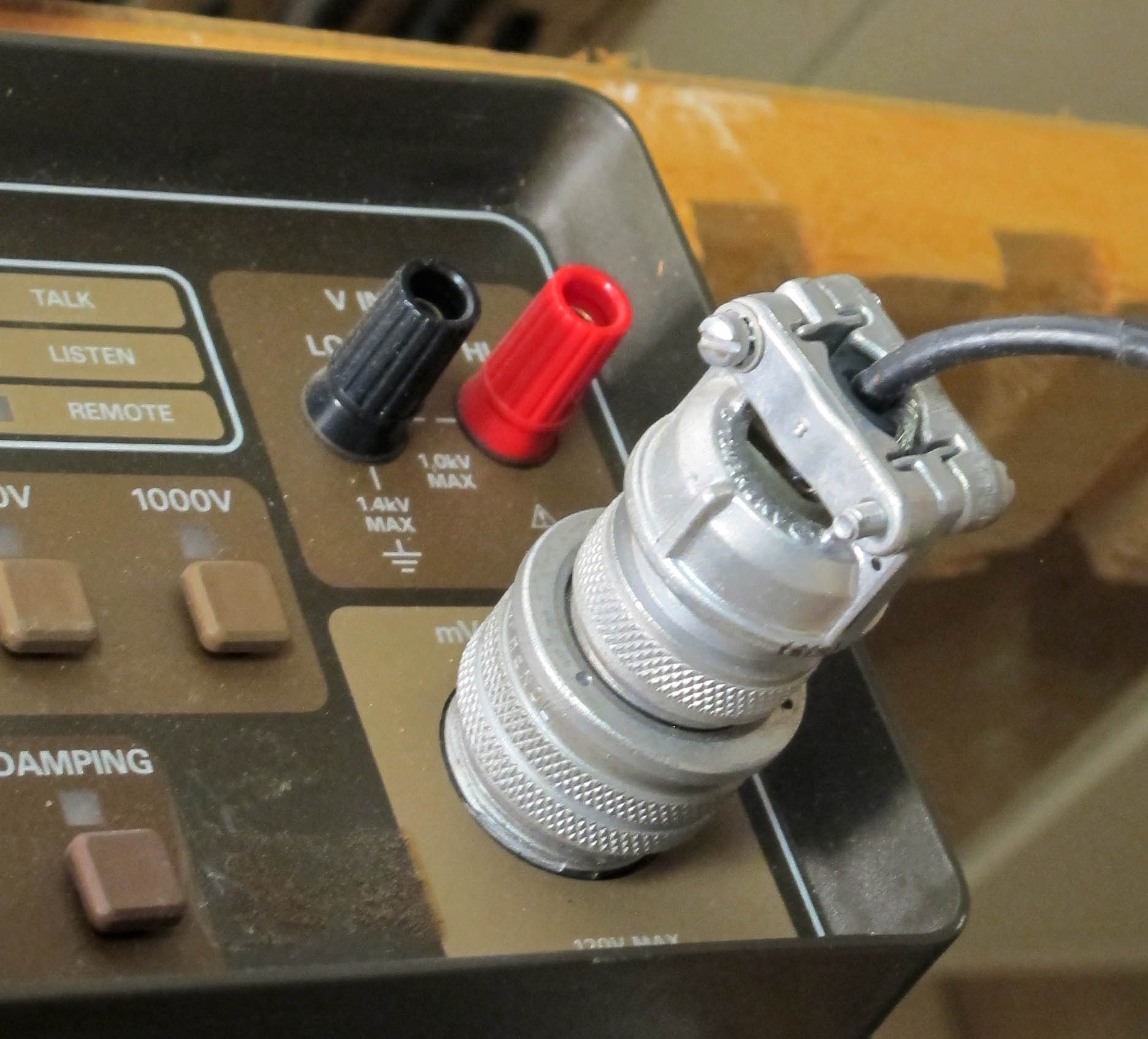

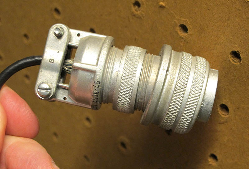

I purchased a Keithley 181 for a song back in the rubble of the dot-com crash. Works like a champ. The connector is the same for the 140.

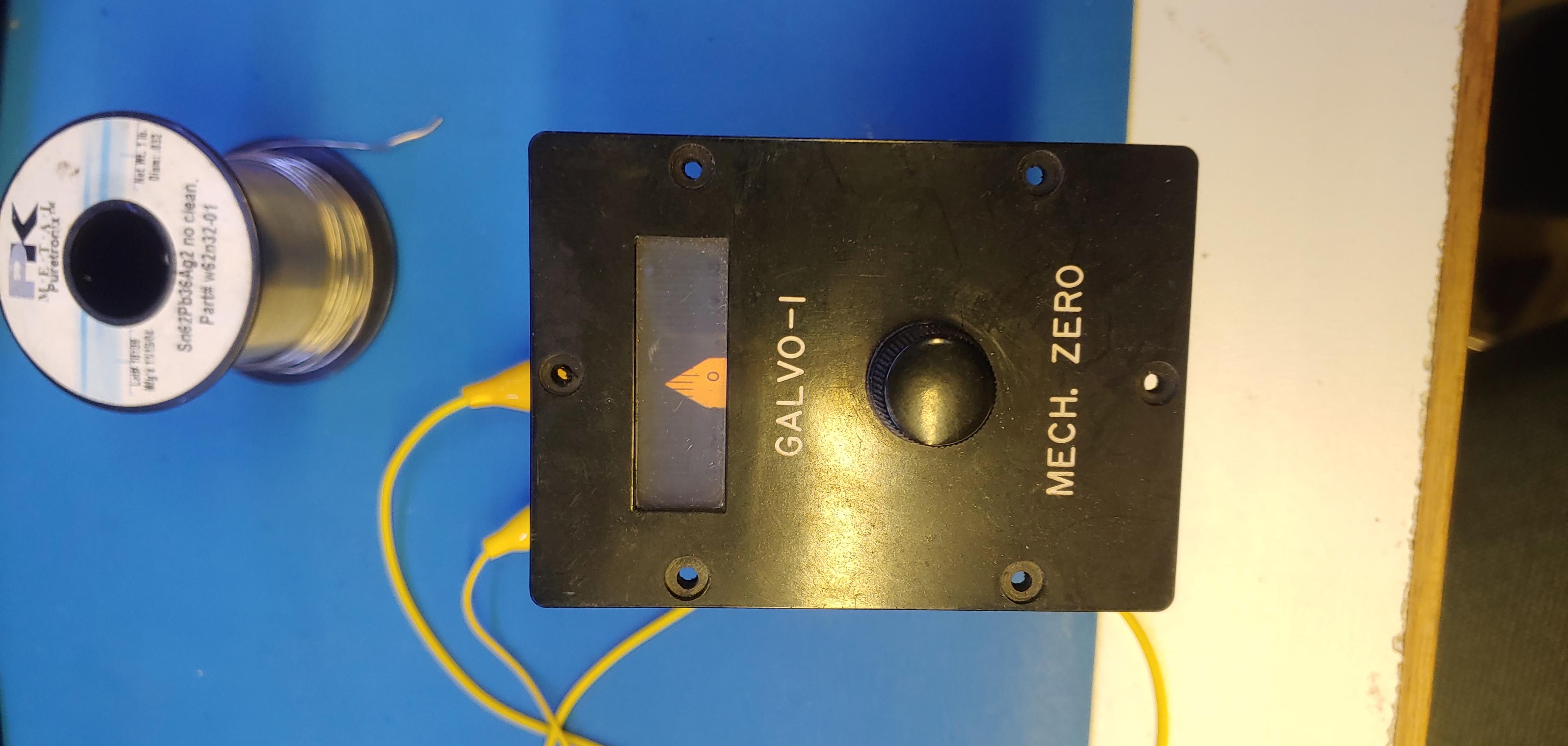

Speaking of high sensitivity I found this in my collection of oddities. Its an optical galvanometer with a 300nA/mm sensitivity. With its 500 Ohm coil that's 150uV/division. These were used before DC amplifiers with enough sensitivity and isolation were available to look at very small voltages, usually in standards labs.
I need to figure out a use for this little number. . .
Remember the movie "Madame Curie" (Greer Garson and Walter Pidgeon, 1943). Marie and Pierre using an optical galvonometer when they were extracting radium from pitchblende.
A little known fact, Jim Williams owned Lord Kelvin's optical galvanometer.
