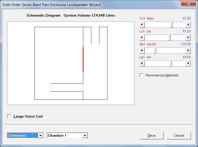

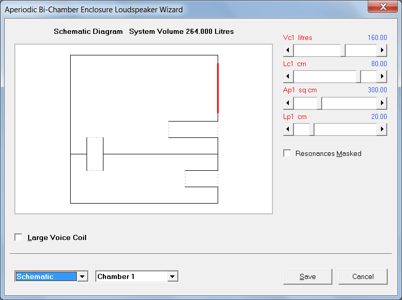

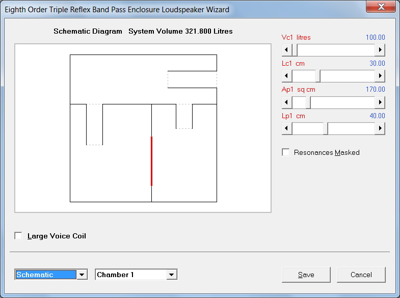

Hornresp can simulate the systems shown below.

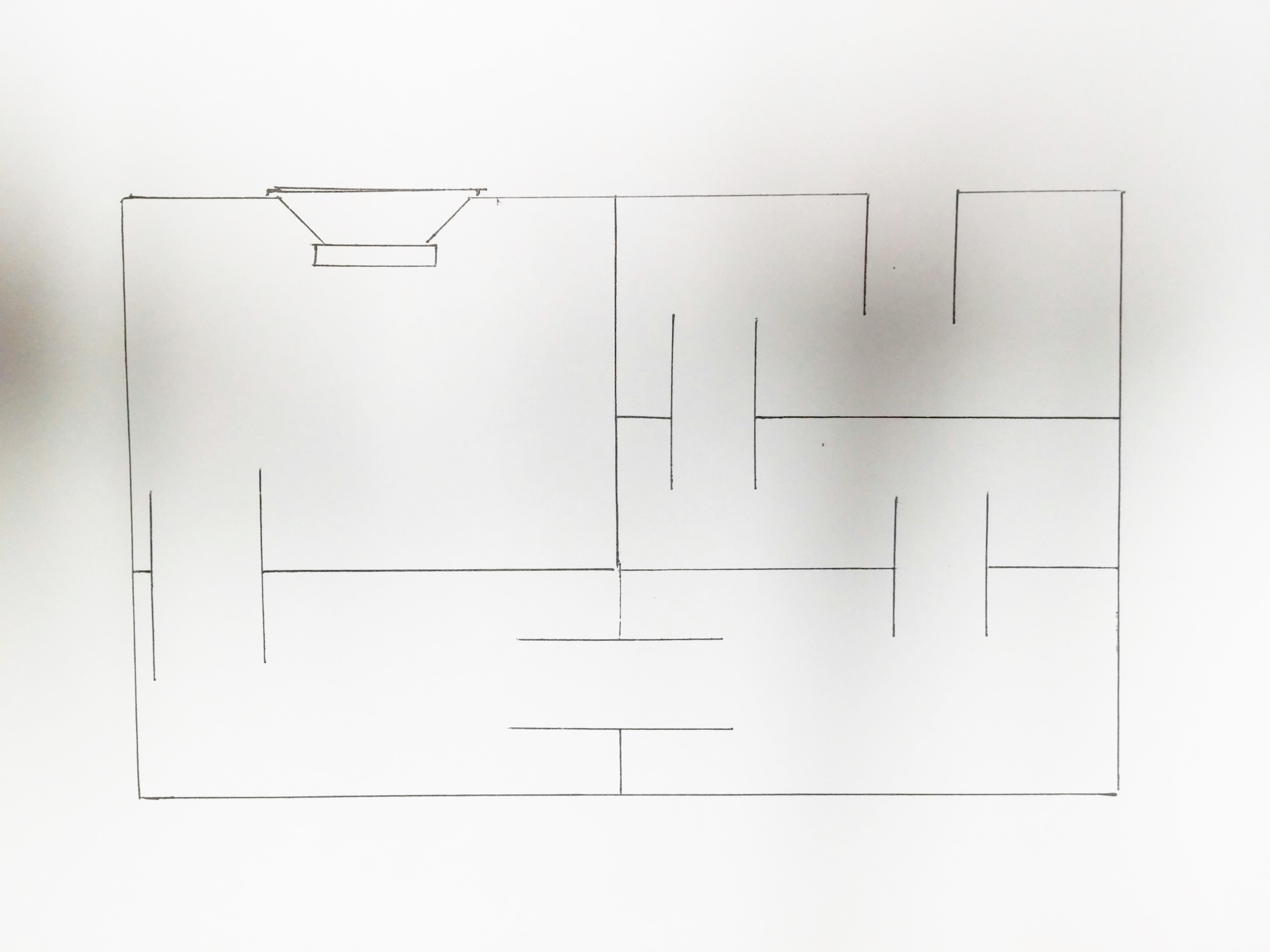

Thank you again for your response. I apologize that I was not very clear on exactly what I am looking for. Also I apologize for my photo below showing what I am trying to get. I have a new computer and haven't figured it all out yet so I drew it out and snapped a photo. This is what I am trying to model. Not necessarily the exact number of chambers but would like to be able to model any number of chambers.
That's too many chambers for Hornresp to sim but Leonard Audio's Transmission Line simulator can simulate every layout in this thread except the 8th order. Akabak can sim them all and much more.
I think you will find that there's a point of diminishing returns when it comes to number of chambers no matter what your goal with using them is. That complex thing you drew isn't going to perform significantly better than a ported box in any way.
Thanks very much. I don't know that I would even want to use that many chambers. I just wanted to be sure I made the point that I am thinking of definitely using more than 2.
Im thinking 3 + with the exact number being determined by modeling and seeing where it goes. I want to model it a few ways and mock some cabinets up and see what happens. I guess in my mind I'm seeing this type design somewhat progressively load the speaker, varying with frequency. So in effect it mat keep the speaker somewhat tight but still allow much of a transmission line response at the lower end of the spectrum. I could be way off on this. Like I said I haven't done this sort of thing in many years. But its always fun to play with it and see what happens. Thanks again.

Akabak has a very steep learning curve, so again, if you aren't good with computers this is going to be a problem. TL.app is super simple to use and very intuitive but there's a few layouts it can't sim, it isn't quite as flexible as Akabak. It will have no problem with the thing you drew though.
