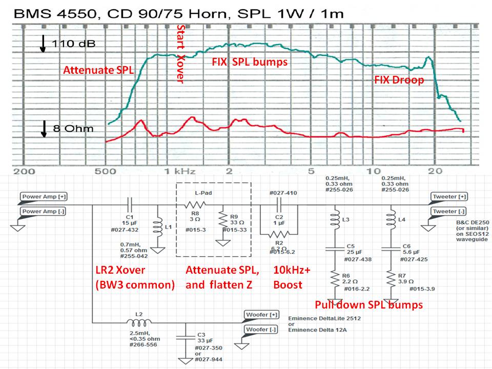

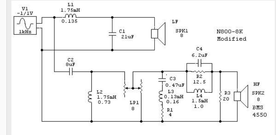

The engineering investment in EconoWave crossovers has produced a few "favorite low cost" and "favorite fix-all" crossover circuit topologies. For each horn, a study of the BMS 4550 SPL/freq plot will often match the challenges of a proven crossover circuit topology. Attached a couple examples.
If you can measure the BMS 4550 on your horn(or find frd files on-line), and put this frd data file into XSIM, you could try -some of- the "favorite fix-all" crossover circuits with values you calculate with "Passive Crossover Design Calculator" for L-pad, RLC notch filters, RC-treble_boost, etc.
