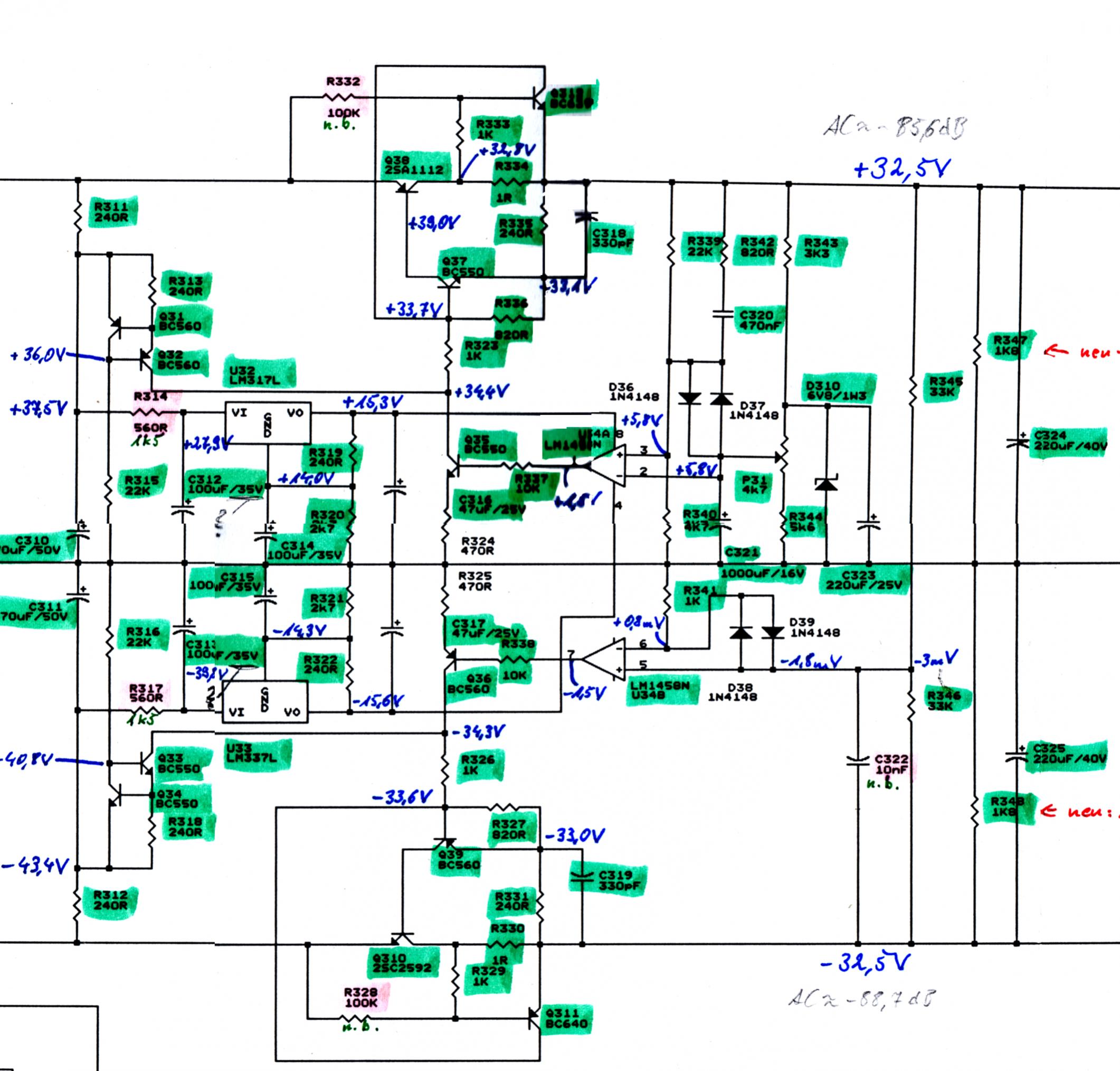

please find attached the schematic of a dual 32 V series regulator
for a "High End" preamp.
The diagram conforms more or less to existing known solutions.
In my opinion the regulator is inherently unstable. In the actual
set up I see oscillation of about 700 kHz - more on the negative
rail (about 500 mVpp) than on the positive (300 mVpp).
At the moment I am not sure about the best way to tame this nasty
oscillation which shows up at the amp output also - I think the stages
are clean, only badly driven by the supply.
Original .tif picture of crazy 90 MB had to be resized and so it is not
possible to read the designations any more. Not sure about the maximum
file size here.

What oscillation frequency do you get without C320 and C322?
If we call that frequency f1, does it help when you place them back with the values changed into C320 = 1/(sqrt(2)*pi*f1*22000 ohm) and C322 = 1/(sqrt(2)*pi*f1*33000 ohm)?
There's a couple of interconnected things here, it seems that the neg reg depends (also) on the pos reg and vice versa. A first step is to get each reg run on itself, and see if the reg on itself is stable, if not, fix that first.
Try to run the pos reg on itself, see how that works.

Problem resolved. It was a bad interaction between the amp and supply.
Oscillating sub-regulators LM317, LM337 in small plastic transistor case,
only used for dc servo op-amps, triggered this nasty oscillation of the main
series regulators. Found a way to stabilise the regs. It is however hard to
fix an existing device without changing the intended topology. Redesign of
this big preamp is not useful and will not be paid.
The phenomenon was also level (relay attenuator and gain change) and
temperature dependent (the amp runs hot).
"N. b." may be something like "niet bezet". Thank you for your attention.
