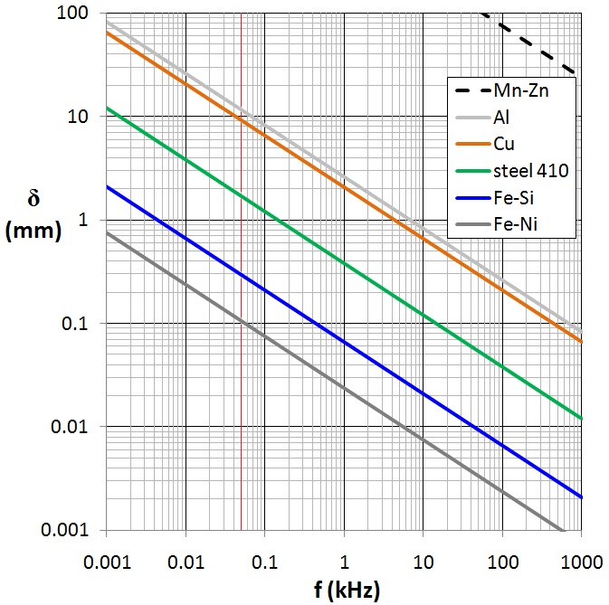

May I ask you more details on the skin effect at power frequencies?

Skin Effect by Nick Wheeler
A very good read lifted from Electronics World, Sep 1997.
And Skin Depth by Zureks.🙂
  • Skin Effect p1-2 Nick Wheeler.pdf
