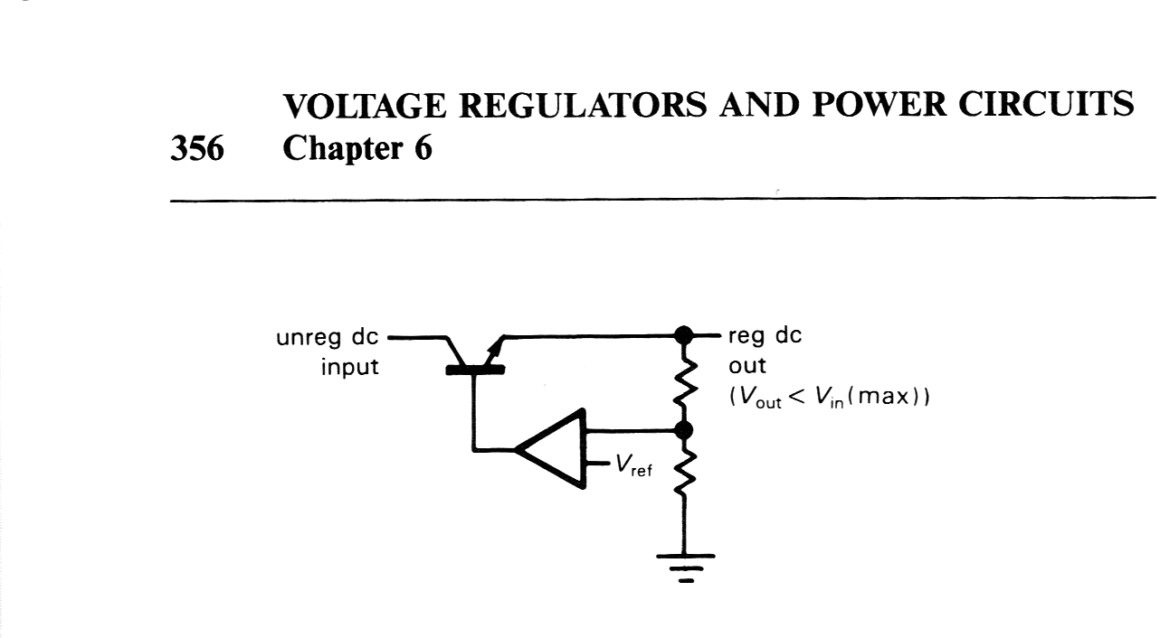

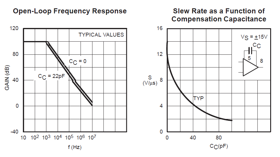

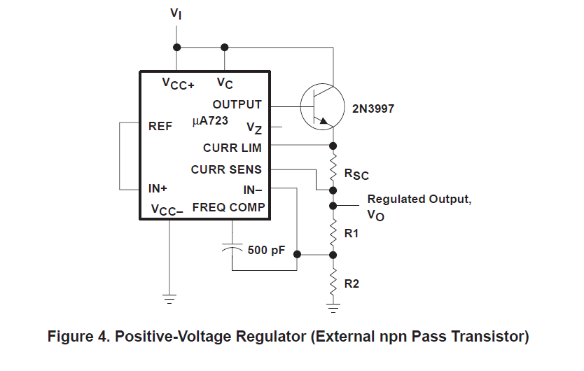

If you need to use an external power transistor + heatsink to get a sufficiently high current supply, I think the best idea is to go ahead and build a complete regulator. You could do it with a uA723 + NPN power transistor and get current limiting thrown in for free. Or you could use an opamp, NPN power transistor, and a voltage reference IC. The key to success for newbies is to select a high-fT power transistor (D44H11, MJL3281A, or 2SC5171) and a medium-to-low bandwidth opamp (GBW < 2 MHz). The OP07 would be an excellent choice; for the brave and the bold, an NE5534A with external compensation capacitor between pins 5 & 8 will give you a chance to fiddle around and "optimize" while still having an extremely stable feedback control system. Will it measure better than a Jung/Didden SuperRegulator? No. Will it be stable? Yes. Will it measure better than an LM317 with an external power transistor? Yes.
