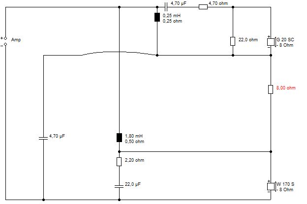

Here's a 8" bass design with 4 ohm woofer that is high inductance, so will sound reasonably bassy. The WLM La Scala reinvented by me. 😱
Next is a cool series filter by Cousin Billy. You can actually replace the red 8 ohm resistor with a fullranger for a three way. Genius.
Modelling required, of course. Downloads

Guys- it's a Magnepan.
There won't be BSC because it's a dipole. At any rate, not the same method. My guess is the driver sensitivities will affect that the most here.
The large membrane can xover wayyyy lower than your average tweeter.
If he's running active, all he needed is the transfer function anyway, and the planar units are likely flat impedance. He's likely pretty close.
When I saw the 0.86mH, I thought that better be a wide-ranger or very robust tweeter xovering that low, but it's likely of no concern in this particular case.
