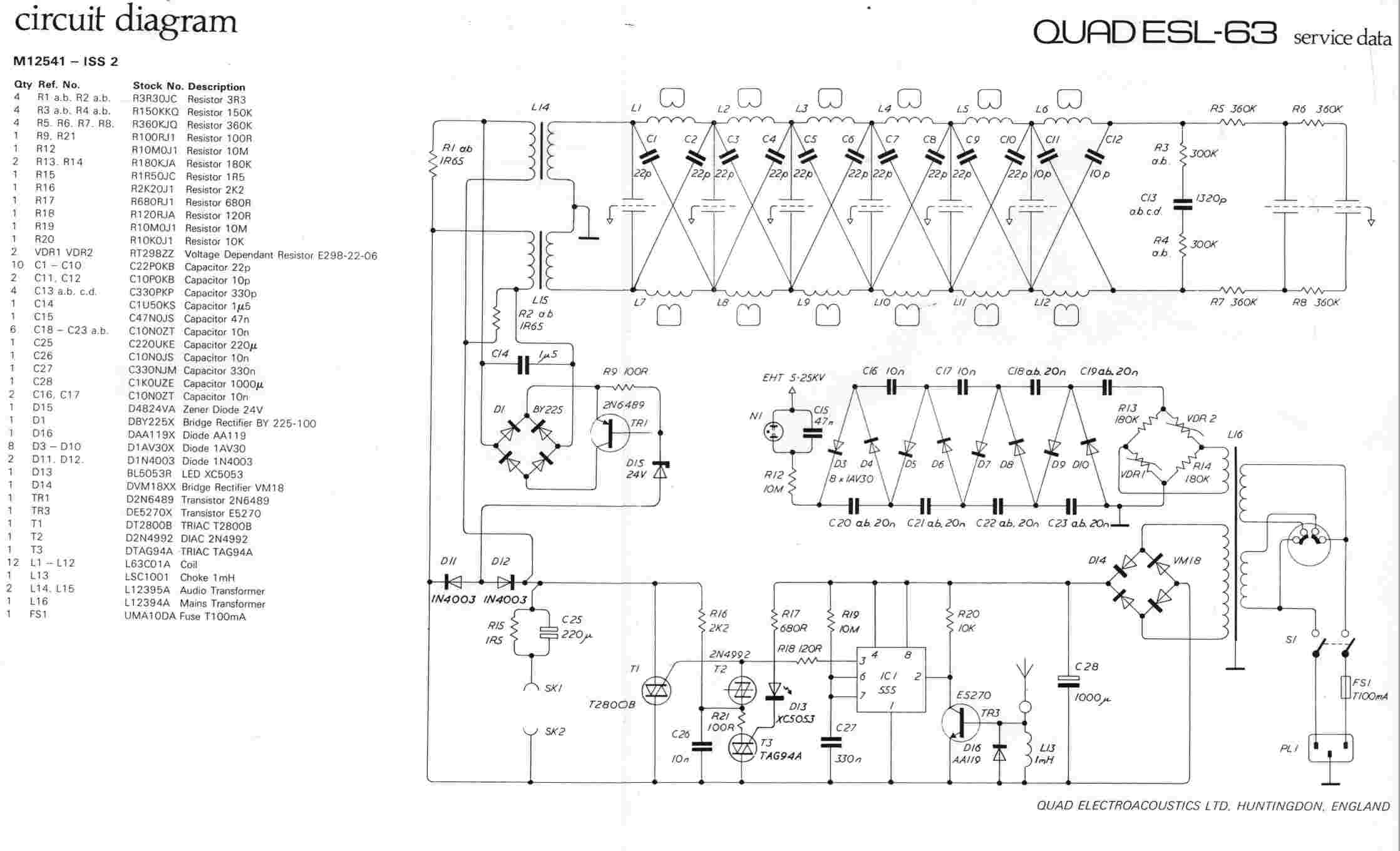

Nope, nothing wrong with your idea.
Quad, Audiostatic, and a few other manufacturers use this technique as do many DIYers.
Usually the primaries are put in parallel rather than series to get higher step-up ratio if primary turns and core area are adequate for operation without core staturation to the LF bandwidth desired.
Quad ESL-63 circuit attached below.
Another alternative for single-ended transformer use is a virtual center tap:

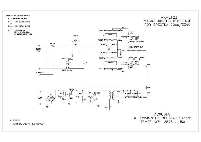

I agree this should work okay, assuming suitable transformers. It also has the added advantage that each transformer is subjected to only half the voltage that would be seen by a push-pull transformer.
This very technique was used in Acoustat's full-range Spectra series. Two identical transformers have their primaries connected in parallel (but out-of-phase), with each secondary driving one stator. This resulted in a much more reliable transformer, and I am not aware of any Spectra transformers having a high-voltage failure. The same could not be said of Acoustat's earlier MK-121 series speakers, where the push-pull transformers are subjected to the full peak-to-peak voltage. Those transformers can arc-over if overdriven, despite improvements over the years (i.e. the Medallion transformers had better arc-over protection than the original design).
