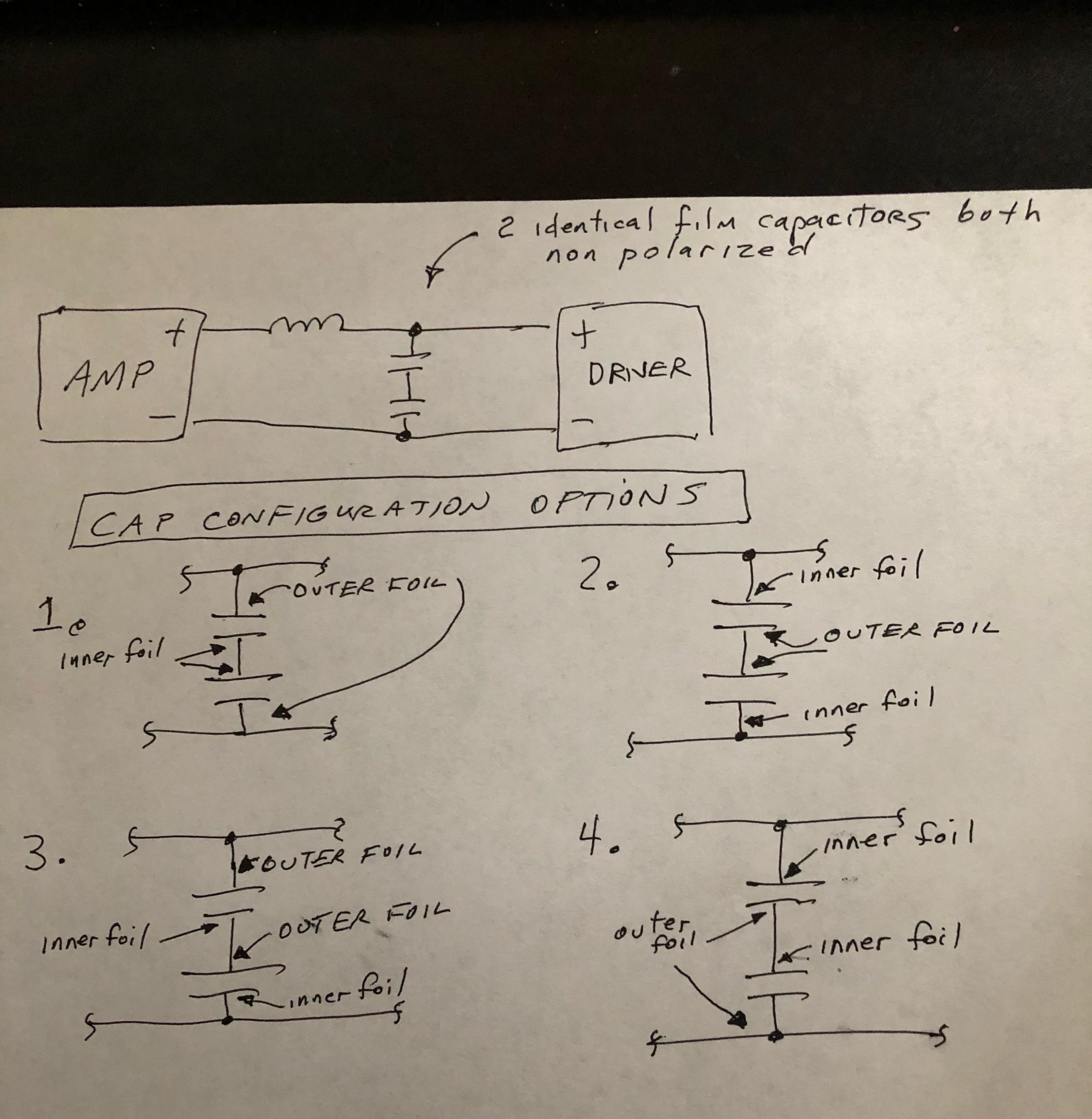

I have confused myself as to the proper way to connect two identical film capacitors in series with regards to outer/inner foil direction in a loudspeaker crossover application. Please see attachment. I'm doing this because I have lots of the capacitors and I need a value exactly half the capacitance. I'd appreciate any guidance as to the proper option listed. Thanks
Connect the outer foil ends together (as in #2), and use the other ends for the connections to the crossover.
Then they can be mounted side by side without interaction. This is not very critical, though.

A wound film capacitor has an outer foil and an inner foil, and if the outer foil is connected to a fixed potential,
or a low impedance circuit node, the inner foil will be shielded from external fields due to nearby components,
board traces, etc. This can be important, particularly in high impedance circuitry and on crowded pcbs.

With the crossover schematic as presented in post #1, there is no advantage at all.
For a start in the crossover schematic presented, the signal level applied will be in the volts, not in millivolts or microvolts for that matter, so noise injection into a capacitor is of little consequence in this application.
The band sometimes seen on a capacitor was to signify the outer foil connection where the capacitor was used as a bypass capacitor, and thus this terminal was grounded to the chassis. This helped to minimize induced noise in high impedance valve circuitry, but not so if used in the signal path.
