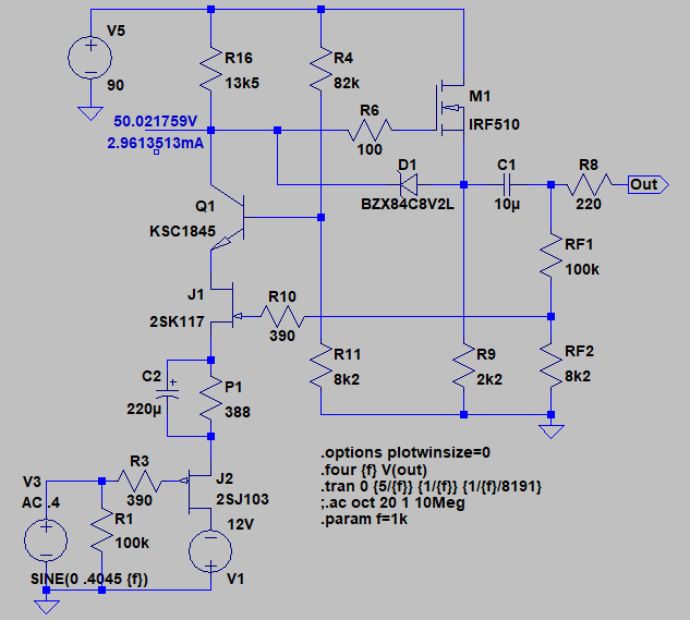

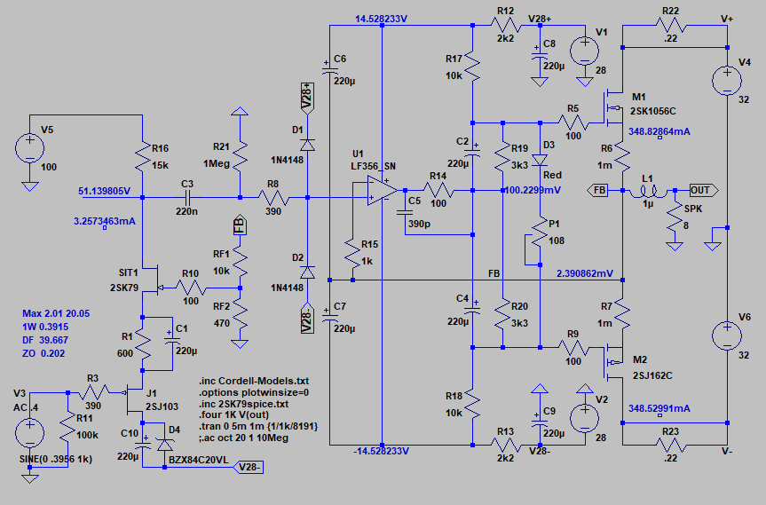

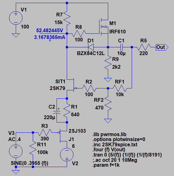

SERFE - a Single Ended Rush Pair Front End

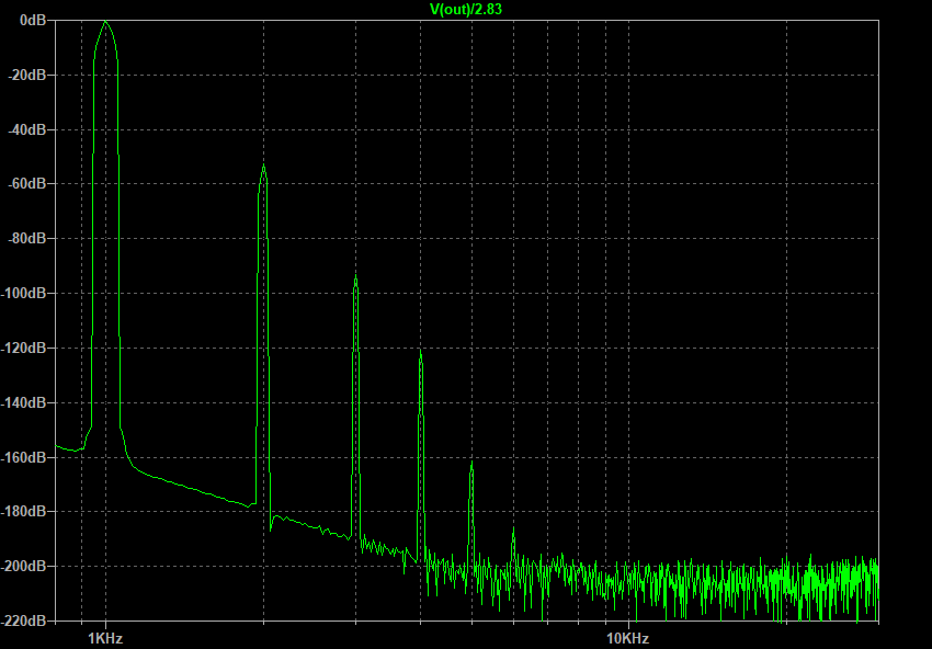

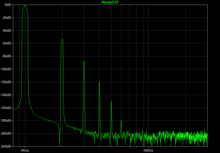

I have a few Sony small SIT 2SK63 and 2SK79, Mu ~30 and 120V Max Vds. Combined with a 2SJ103 GR to form Rush pair we have a non inverting gain stage. 5dB feedback allows for gain of ~20dB. Predicted THD of ~0.23%, negative phase H2 dominant with H2/H3 ~33.9dB.
I call it SERFE K79 to serve a need for spooky presentation. 🙂

Total Harmonic Distortion: 0.230840%(0.230840%)

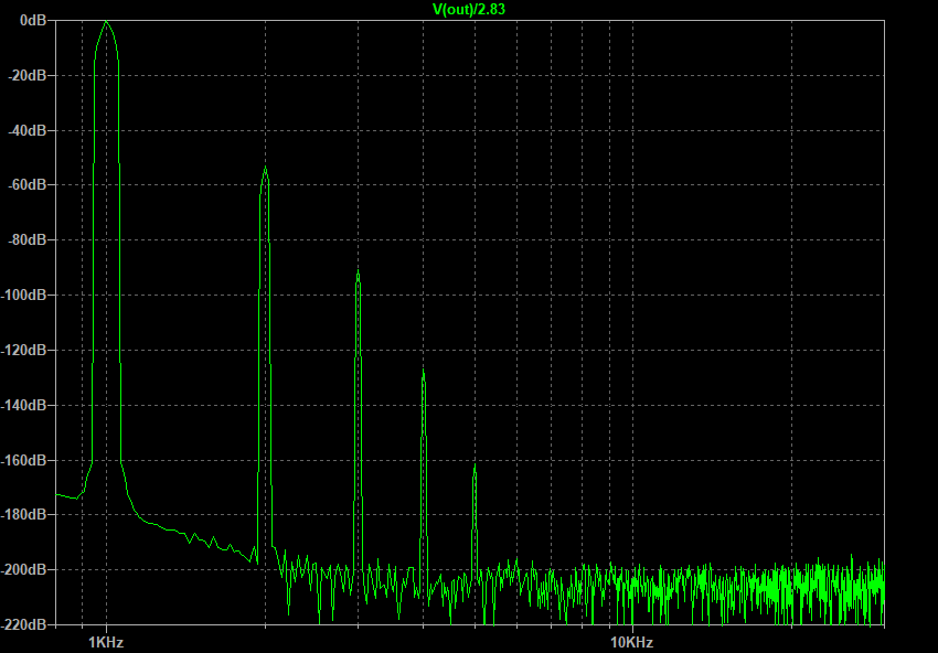

Pic 2 - FFT spectra at 8Vpp output.

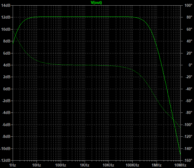

Pic 3 - Frequency Response.

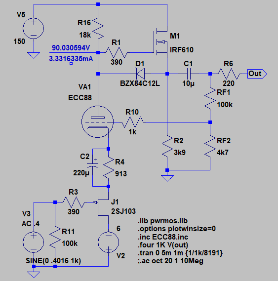

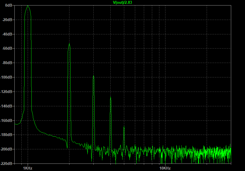

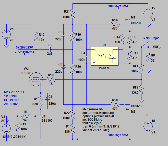

The topology also works for other Jfets, Mosfets, Triodes and Pentodes.
Pic 4 - SERFE ECC88
Pic 5 - FFT of SERFE ECC88 with THD ~0.23%, good H2/H3 ~45.3dB
Pic 6 - Mated to M2 output stage to make 25W class A
Pic 7 - Mated to a 50W class AB composite power buffer.
Pic 8 - 14dB (5x) gain headphone amp version with ECC88

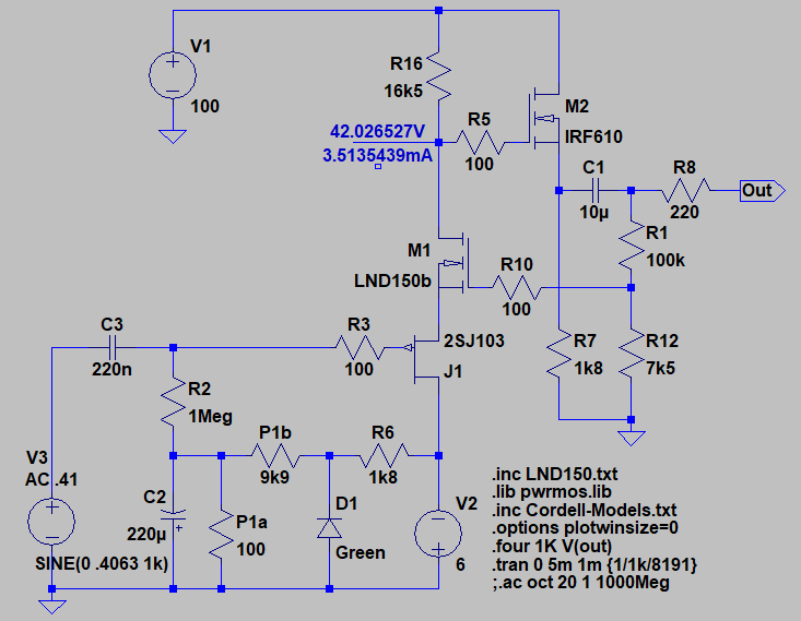

Pic 9 - SERFE LND150 Lateral DMOS version
Pic 10 - FFT of LND150 version
Pic 11 - SERFE K117 - Cascoded 2SK117 (or 2SK209) version
Pic 12 - FFT of K117 version

me likee,Mighty Indra!
you need intervention there , to comply with name - toss "pair" from thread title
(years ago, I was so bloody smart, so I invented Rush cascode/diff pair ...... was so proud for a day; not first, not last time .......... :rofl: )
have plans to put proto ?
