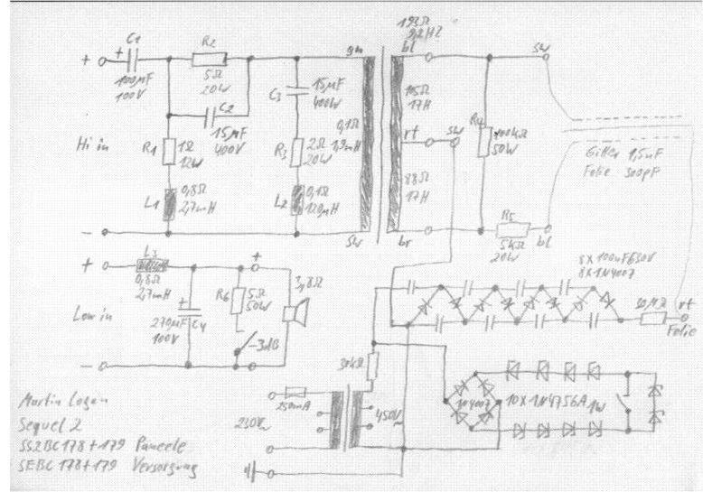

Assuming you mean Martin Logan Sequel II?
You can't measure the HV output with a multimeter, it is very high impedance and drops from the multimeter load.
I assume you mean the HV bias voltage, or do you mean something else?
The schematic can be found online - 5 seconds with Google, see attached.
