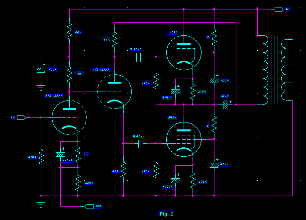

I found a SEPP circuit from an old magazine of year 1966 as Fig-1 shown. It was using an output transformer which has two groups of primary windings. Can anybody explain what is the different if using a single winding transformer as Fig-2 and the advantages and disadvantages in comparison?

Fig. 1 shows 2 windings, each with screen current drawn through it in opposite phase, therefore the DC cancels.
AC wise, it's the same as Fig. 2.
But there's a hair bit of DC in fig. 2 that appears to be some FB method to the driver tube.

Fig1 is right for pentodes fig 2 is only work for triode.the two resistor of g2 will eat most of the output power.

For audio power SEPP amplifier look at the Philips AG9015 ... normally those 2 windings are just for G2 supply and there is a third winding from middle point to ground coupled by an electrolytic cap used as primary . Or OTL 800ohm without using the transformer .
This is because without independent floating G2 voltage for the upper tube ( too expensive in those days using tube rectifiers ) you need the winding inductive reactance in series with G2 , just using low-ish resistors would short the output power to ground / B+ .
And using high value resistors would greatly limit the power ( they did this in TVs and radios just 2-3W from 2 tubes) .
For low power , like in the generator schematic , probably the 2 windings can be used also as primary , but only if you use one winding for both tubes the Raa is reduced by 4 - the advantage of SEPP
So if you use modern floating power supply for G2 , or with triodes , you don't need the two windings , you use a simple like SE transformer but without air gap of course . .
