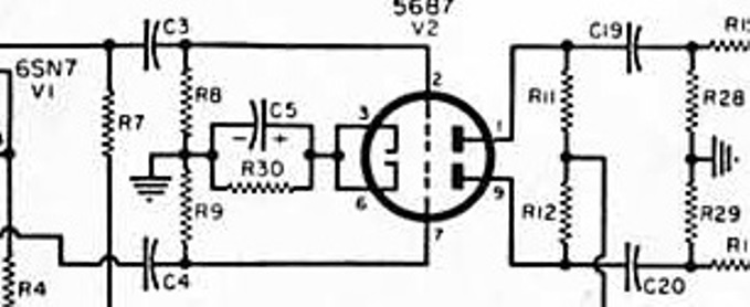

Good Monday everyone,
In this schematic R30 is 1200 ohms, 1W, if I wanted to separate the cathodes and give them their own cathode resistor, what value should I use? As a reference, R11 and R12 are 25K and B+ is 475.

Another way of saying what other folks have already said (and better than me) is that leaving the common cathode resistor, in what looks like the middle stage of a DTNW amplifier config, unbypassed is usually the best design choice. Output stages with cathode bias benefit from individual cathode resistors, each with her own bypass cap, but the driving stage (normally) has a slightly different best design balance.
In either case, as jws has said, the capacitor is a liability.
All good fortune,
Chris
As Chris has pointed out, that's a typical Williamson front end. Usually that cathode resistor is unbypassed. I'm not sure why it is bypassed in this particular amp, perhaps to increase the gain to the output stage, or reduce distortion. But in most cases, for this type of design, you would not use a bypass cap in this position. But also do not use separate cathode resistors, the stage is designed to work with a single shared cathode resistor.
Some amplifiers on various threads of this forum DC couple from the driver to the output tubes.
If you are going to DC couple a driver to the output tubes, and you use a common cathode resistor for the cathodes, you better make sure that the driver triodes are exactly matched.
Otherwise, the output tube currents will be badly unmatched.
5,000 uMho output tubes and a 2V mismatch of the driver plate voltages causes a 10mA difference of the two output tubes current.
That is not good.
Ask your push pull output transformer if it likes that!
