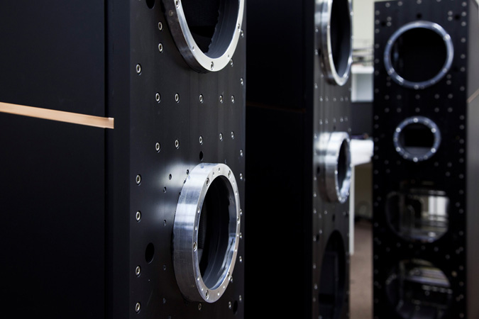

There are (at least) 2 issues with a double baffle system:
1. Mechanical coupling: If the 2nd baffle is touching the 1st baffle or any other part of the cabinet for that matter, the transfer of energy flows freely. On the other hand, if you decouple the 2 baffles with a viscoelastic material that resists the transfer of energy, like sorbathane or butyl (like wesayo has done above), then the 2 baffles will work together to form an effective system.
2. Choosing the correct implementation for the design: Are you actually building a single-way speaker like a guitar amp or sub? Or line array I guess too? Or a 2- or 3-way speaker? Because with a multi-way, you might also want to make sure you are isolating the mid and/or the tweeter from the larger mechanical energy produced by the woofers.
Magico for example has been using a double baffle system on some of their speakers for years. Woofers are rigidly attached to the 1st baffle, the mid is attached to the 1st baffle also but decoupled with a viscoelastic gasket and the tweeter is attached to the 2nd baffle also with a decoupling gasket. Another larger gasket is used between the 2 baffles. Don't ask me what the gasket material is because I don't know - I've never seen that mentioned before. Maybe someone else knows?
From my limited experience, the hardest part is designing how to attach the 2nd baffle while keeping it decoupled from both the 1st baffle and the rest of the cabinet too. Magico rigidly attaches the 1st baffle to the cabinet and then attaches the 2nd front baffle and the rear baffle together with threaded rods. The rear baffle may or may not also be decoupled - I'm not 100% sure on their latest design pictured below. Also attached are close-ups of the baffles.
Recently, I gave the method a try as well but I took it a step further. It's a 3-way with a triple wall cabinet construction so that every separate chamber (3 of them) are also mechanically isolated from the outer cabinet walls as well. Green Glue was the choice between cabinet layers and sorbathane the choice between baffles. The 1st baffle has the woofers rigidly attached but is broken into 2 parts, 1 for the woofers and 1 for the mid to mechanically separate those two. The 2nd baffle has the mid and the tweeter rear mounted with sorbathane gaskets with additional sorbathane between the 2 front baffles at other points. I have 12 threaded rods holding the decoupled 2nd baffle to the back of the cabinet exterior layer. I did the outer layer in fiberglass, the inside layer out of cement and the middle layer out of rubber - the whole thing was a bit of an experiment to build a cabinet out of alternate materials and see how far I could take it. It worked better than I expected but lordy, lordy, it was one hell of a lot of work. Still have the final finishing to complete. See next 5 pics.
Btw in the case of the guitar amp you have shown, without mechanical decoupling, I think it would simply be better off with a single baffle and better cabinet bracing and stuffing.
