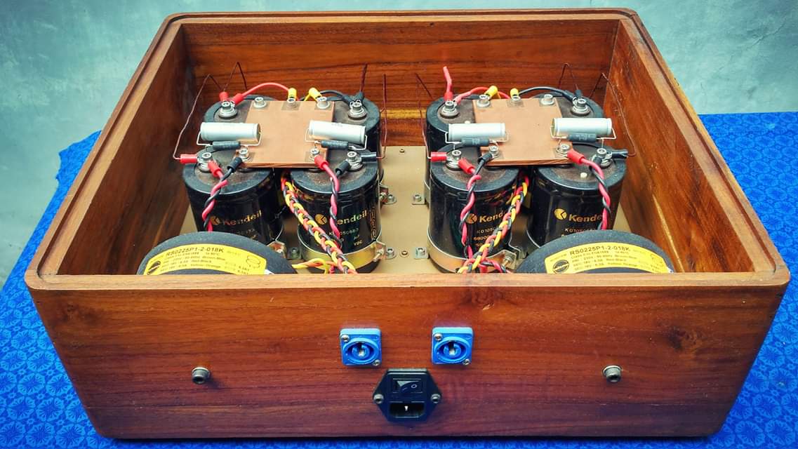

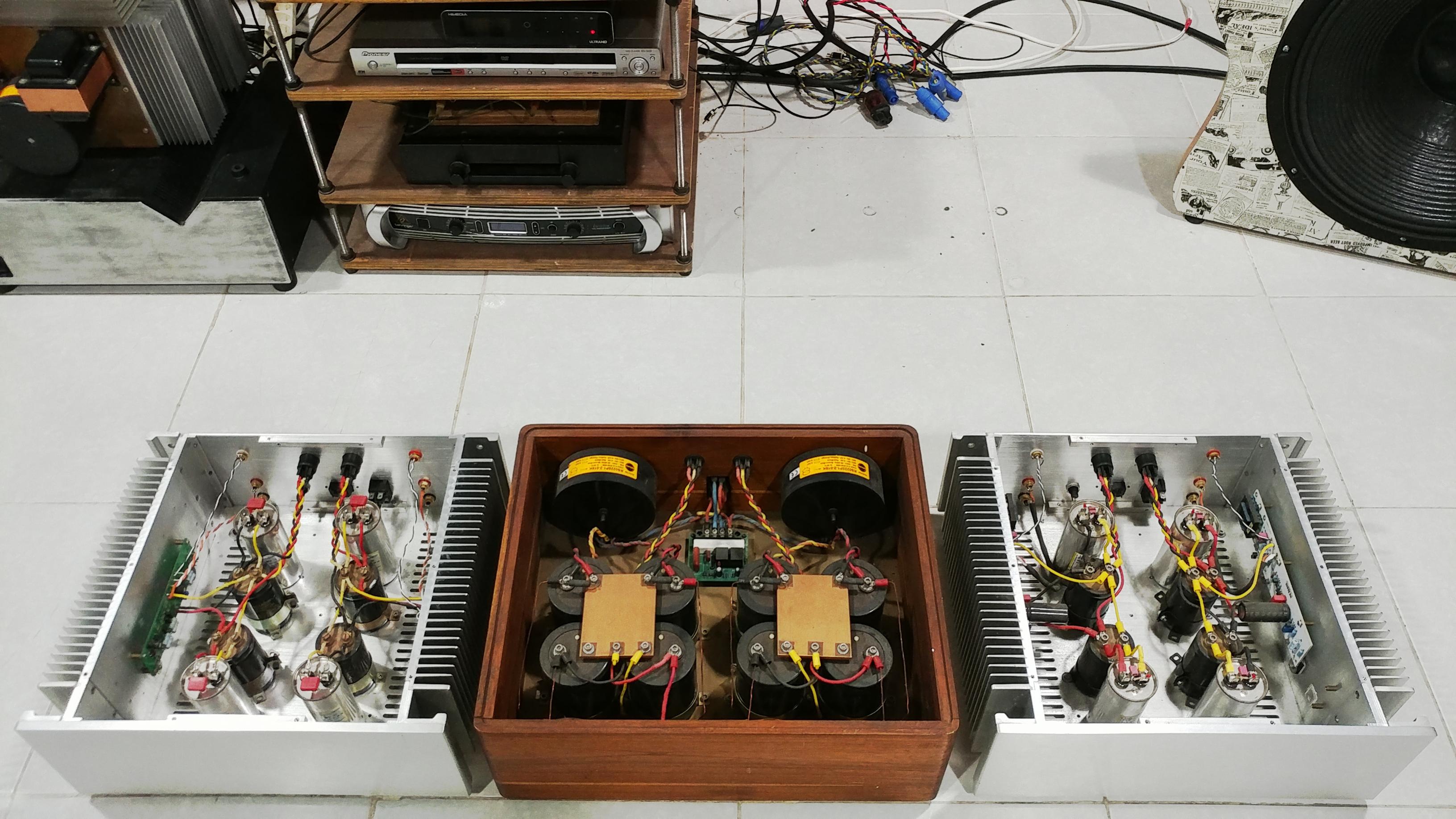

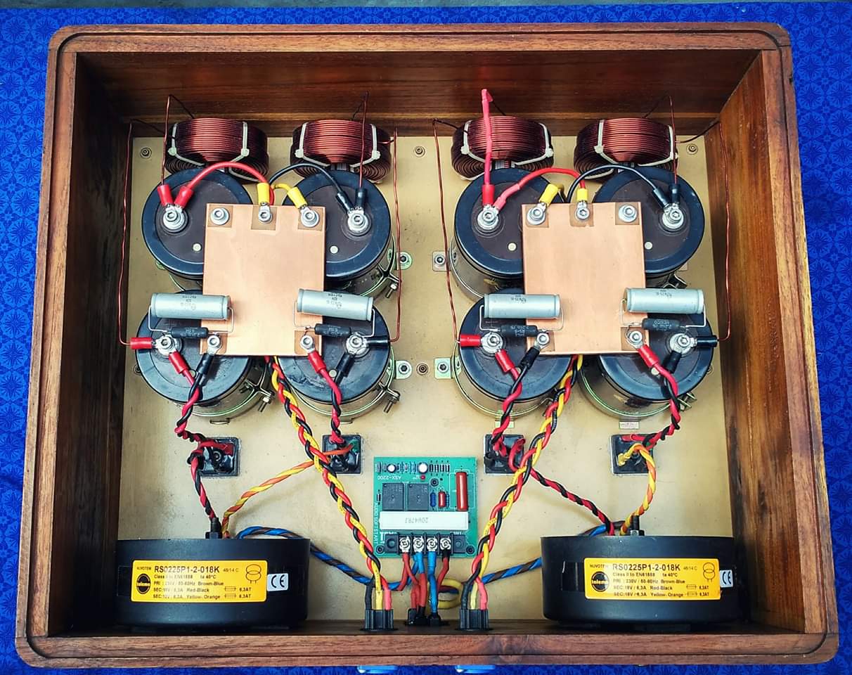

i have built 2 versions of my diy audio rack, the idea to keep everything together. but now I'm bored to see so many items in front of me so decided to move out the rack and just put dac and cd player in the centre and monoblock amplifier on each side
with my 2 chassis amplifier and separate psu box, i have 2 options:
1. only need to extend DC cable length into 2.5m (room width is 5.8m) and put psu box in the centre below dac
2. disassemble psu box and put toroid + CLC on each amplifier chassis which become true monoblock build
- i have seen commercial amplifier with separate psu chassis but with 2.5m DC cable will be safe? (option 1)
- toroid and inductor on same chassis with circuit board might give negative impact, also it's a shame the nice teak wood chassis should be dissambled (option 2)
any opinion which one is better?

i did not think for this option but interestingBest option would be to build another of these beautiful teak wood chassis and place them each under their respective amplifier box ...
Of course, that is also the option that causes the most work ... [emoji14]
Regards, Claas

dunno, in overall scheme , price of Donuts and several caps is not going to break a bank
I see some Greedy Boyz paying plenty for terminals alone ...... go figure
I'm perfectly happy with Neutriks for input and ancient Hirschmans for output
in short - each of my amps is deserving own guts

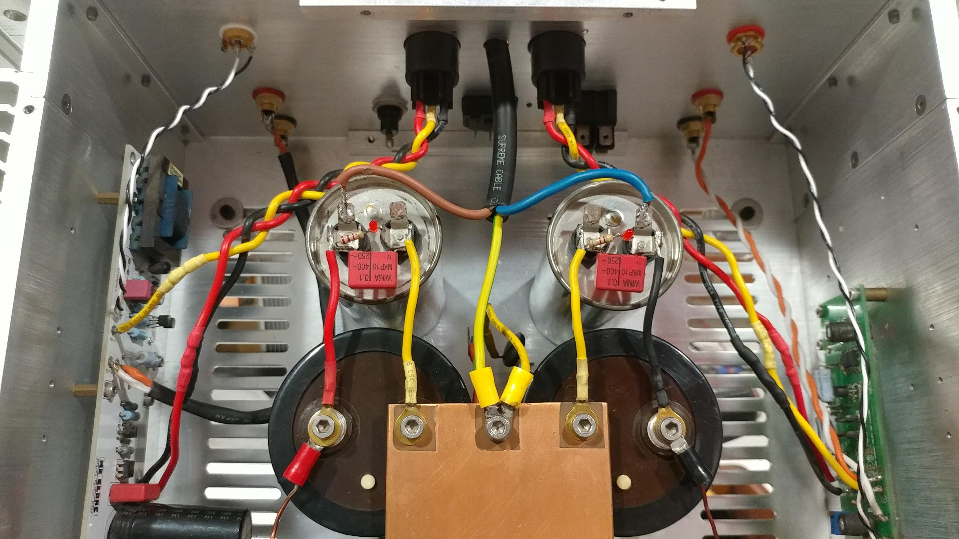

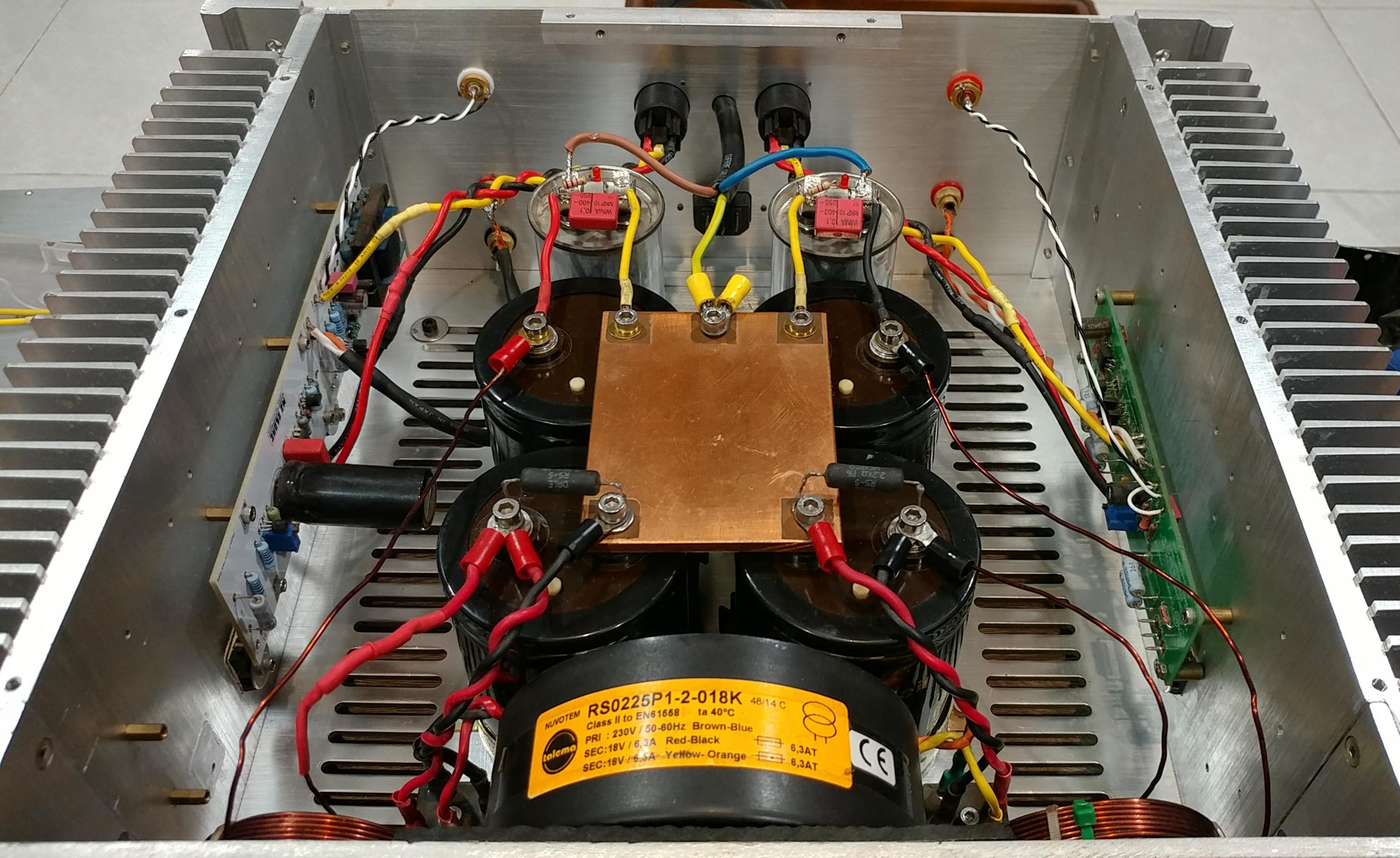

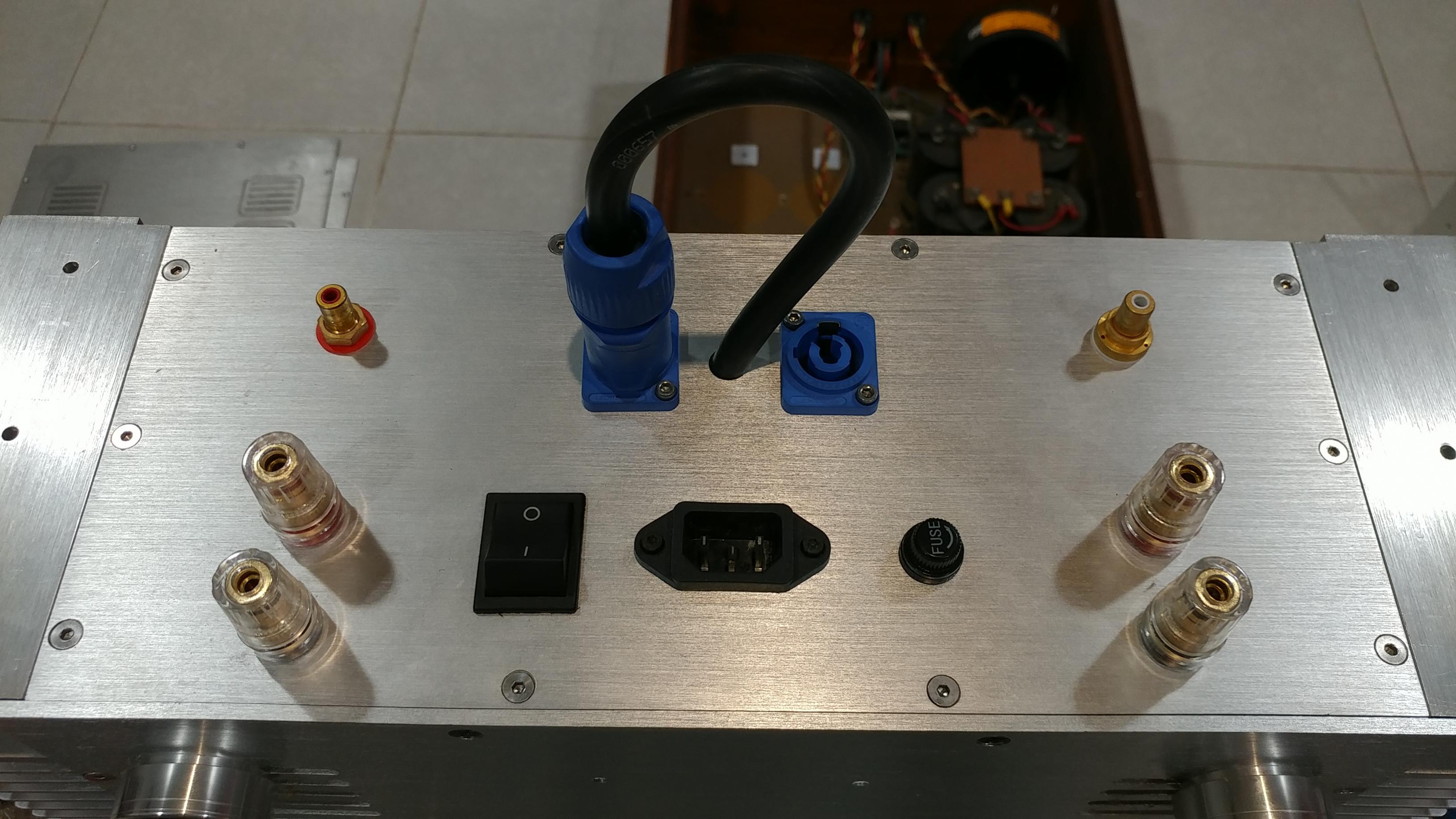

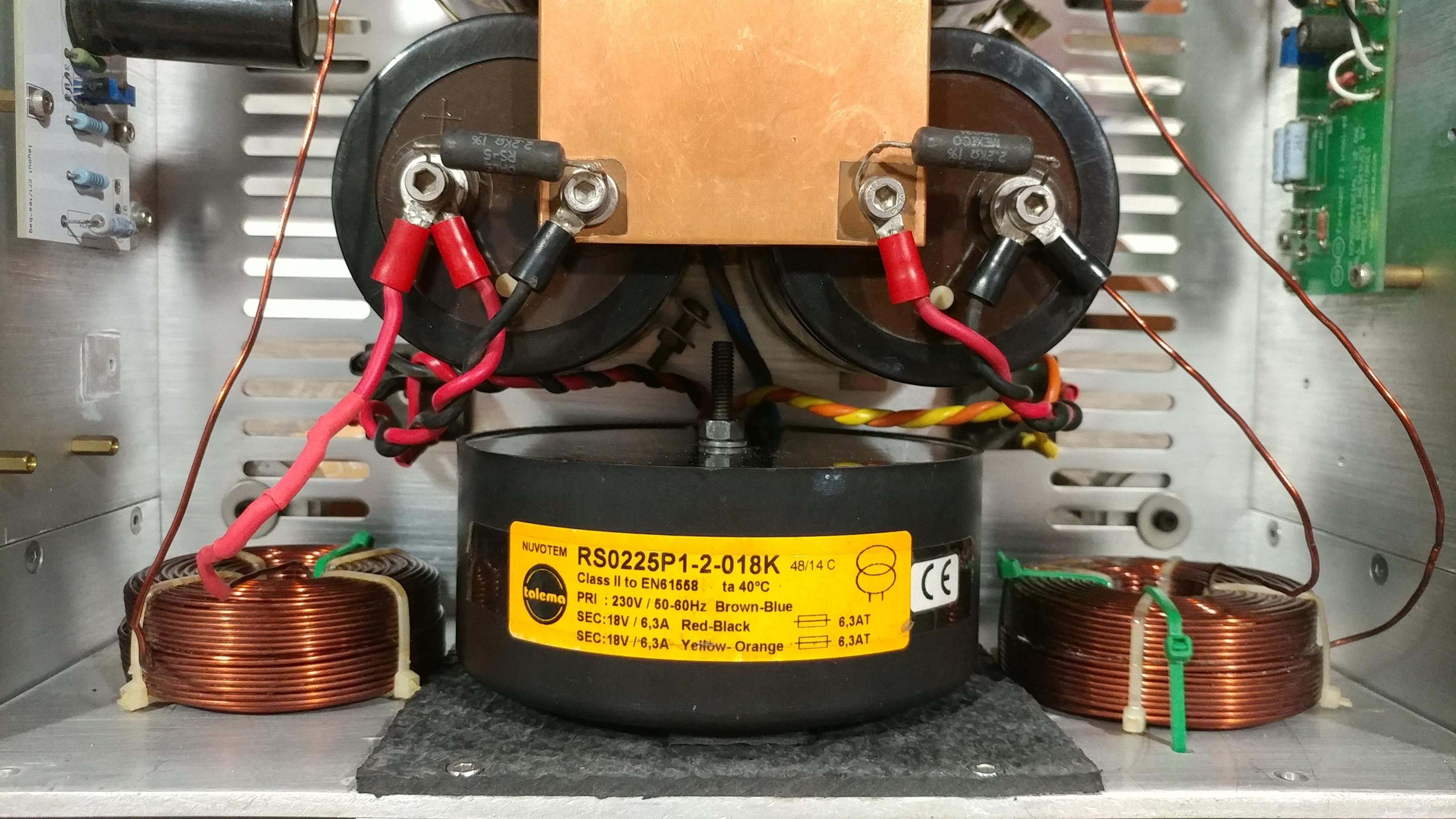

with self lockwown and WFH i can get extra time to rework my FW clone. previous seperate psu box which make monoblock, now i put each toroid on each box with J2 and M2 board on each side. i can switch the supply easily with Powercon connector.
