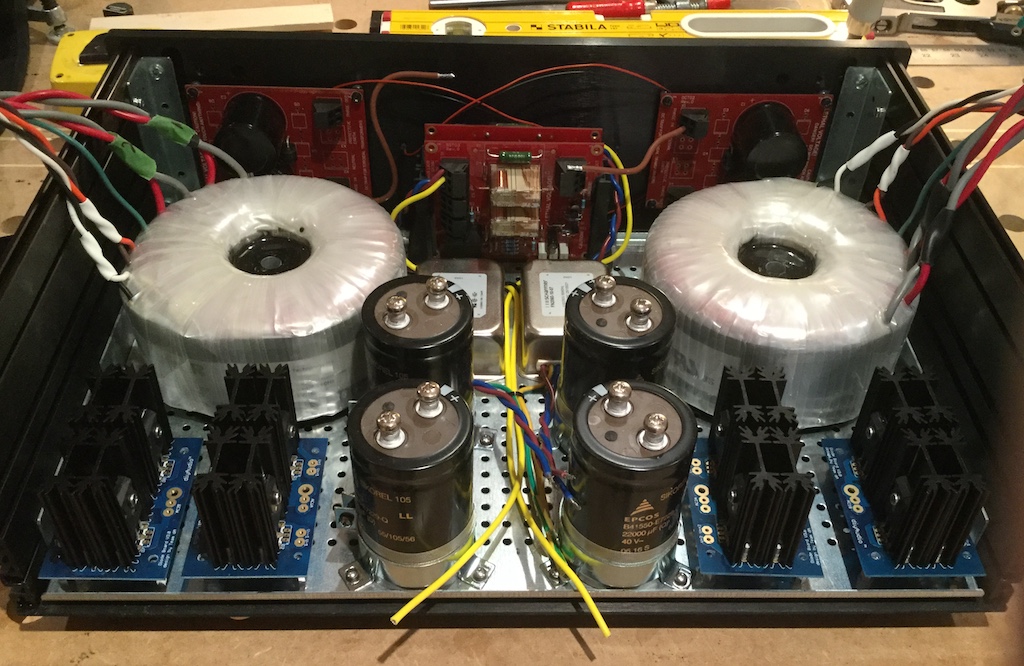

Me too. My thoughts for the separate amplifier psu revolve around: i) given the similar power requirements of many of the Nelson Pass designs, why not?; and, ii) to reduce em/rf emissions inside the amplifier case.
Here is a picture of my work in progress. The transformers are 500 VA Primrose 2x18V, and you can just glimpse the line filters, soft starts and DC blockers in the background.
Each transformer circuit is electrically separate other than common points at the IEC inlet and a single common ground point. Rectified DC will be filtered via CRC through the oh-so-shminky Sikorels (sort of a birthday present) and then out of the case via Powercon32 connectors (they are very slick).
The rectifier bridges (Graetz) fit nicely, although in hindsight I would have been better off with a deeper case (this is a Modushop Slimline 3U x 280mm).
