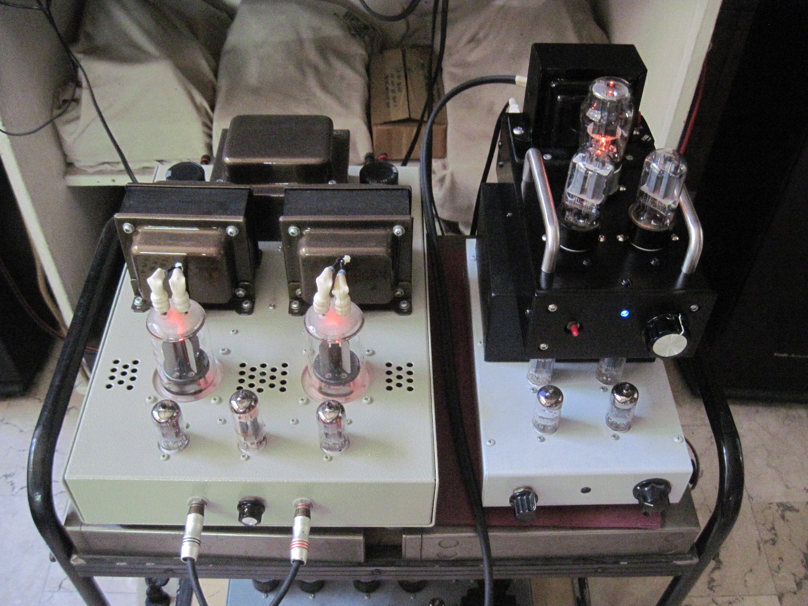

I wonder where this stands in terms of audibility? Separating channels from each other has, in my limited experience, made an audible improvement. I have, for example two RH84s Rev2. One was made with high quality parts as a regular stereo amp, and the other made from junk box parts as a throw away and has two full power supplies. It is two mono blocks in one box. The junk box one sounds better. This is not scientific of course, but it seems that most people would agree that mono block designs are better sounding.
My home SET amps use two different power supply rails. Tube rectified and choke input filtered. One main benefit here is the lack of a huge resistor needed to drop the voltage.

Splitting the power supply has its sonic subjective benefits IMHO, but the best for you is to try yourself. It will also cost and weight more.
Although I'd bet on a single supply with higher quality parts than two split supplies with poor parts. The choice is yours.

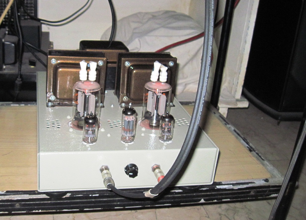

that is typical in any tube amp.
i did a 5894 SET wherein the output tubes are fed from its own psu,
the voltage amp and the cathode followers are fed from its own power supply on a separate power traffo winding and at a bit higher at 400+ volts, whereas the output tubes were fed from its own psu at around 350 volts.....

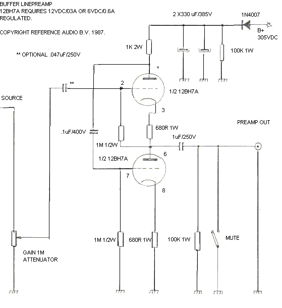

If the diodes are forward biased then they achieve nothing. If they are not then either they are acting as main rectifiers, or they will introduce distortion into any interchannel crosstalk which is present. So better off without them. I know there is a myth that diodes can pass DC while blocking AC but this is a myth i.e. not true.
i will not contest this....but hey diodes are so cheap i buy them by the hundreds...even if i need just a pair or two...you are right about the myth....🙂
here is what frank said....
"What is the purpose of the 1N4007?"
I knew you'd ask about that.
What it does is preventing the PSU caps in the preamp chassis to discharge into the PSU chassis proper.
Basically this prevents arcing when connecting the two chassis together.
In view of the fact that video connectors multiple poles are used to connect both units over an umbillical cord, see it as a safety measure.
Doing away with it can cause serious damage to the connectors and arc-overs are definitely real with this kind of voltages and caps.
