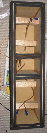

I made a prototype enclosure (non ideal... long story) for my mtm project. Some of the acoustic measurements have been far from ideal.... one key thing with it was that I wanted to use a separate volume for each driver completely sealed. Therefore my enclosure has three completely separate volumes one for each mid bass and one for the tweeter.
Now the thing that bugs me about this is that in order to get the tweeter in close proximity to the midbass' The midbass drivers have to be mounted very close to the top/bottom wall of each drivers volume, and I'm not sure if this is a problem. I'm starting to think that maybe I should build a single volume enclosure. What I'm concerned about is strange reflections because of the close proximity to the wall.
One thing I have been thinking today is that maybe I should angle the partitions at 30 deg so that I end up with a rake back behind the driver (and non-parallel walls top-to-bottom internally).
not that it is probably relevant but the drivers are morel MW144's and DMS37.
picture of prototype box attached, note that it is too narrow (175mm outer dimention for width) new box will probably be 225mm outer with 25mm chamfer on the baffle (using 25mm mdf). Arrived at after modelling in BDS.
So The question is: Is any supposed benefit of having separate volumes for the midbass units going to be canceled out (or perhaps made worse) because the drivers are mounted too close to the top (or bottom) sides of the separate volumes.

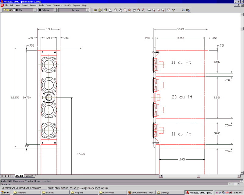

If the drivers will be wired in parallel and the baffle step compensation will affect both drivers, a single chamber will be fine. In other words, two chambers are not required if it's a normal 2-way crossover.
If the MTM is a crossed over in a 2.5 way format, the woofers should have separate chambers. Not doing so results in slightly ragged response in the lower midrange because the driver's back pressure is different between 200 and 1000 due to BSC. Most 2.5 ways are TMM format though, so this may not be a problem.
The issue you mention about having walls in close proximity to to a driver has never caused much of a problem for me. In fact, I once used a 5" tube for a midrange enclosure, and with a good amount of damping at the back, the response was very smooth.
Anyway, I'm doing sort of the same thing with an MMTMM, and the outside woofers have a wall in close proximity to the driver. The outside drivers are the ".5" in a 2.5 way, and they need separate enclosures to avoid driver interaction in the 200-1000 range.

Thanks Zaph 🙂 I wasn't planning on doing a 2.5 way, but since doing the separate chambers isn't that much extra work, and it sounds like I shouldn't worry about the proximity of the driver to the edges, I think I'll go ahead with separate volumes, as it gives me the flexibility to change if I want 🙂
I was planning on having an external crossover with separate binding posts for each driver to give me the most flexibility, so I can change to my hearts content, or even go fully active If I feel then need.

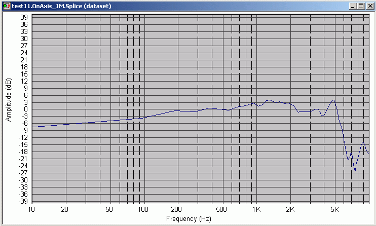

Here is the gated response I took the other day... nearfield is spliced in but at the resolution of the gated, so is a bit useless 😉
edit: my drivers are a little closer than in your plans 😉 there is about 1mm between the cutout of the MW144 and the top of the box 😱 I think I might laminate two pieces of 18mm MDF leaving it at only 16mm thick at the tweeter end, that should give me a bit more space whilst still having a solid partition, and being able to get the tweeter and mids close enough together.

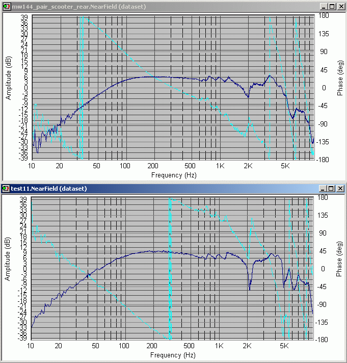

On the subject of sus acoustic results, I've attached two nearfield tests that I did. One was a while back, and the other I did just the other day. The top one looks very good to me, the second one looks very similar, but the thing that is bugging me is the phase reversal at 300Hz.... I'm planning on crossing these at 300Hz (I'll have a pair of stereo subs), and the first graph shows 0 deg at that point but on the second it looks like it would be the worst possible cross point phase wise.
What would be the likely cause of the differences in the two measurements. Both were done using speaker workshop and a WM60AY (un-modified) mic with Wallin II preamp. I only got good results like the top graph for a very short while, and since then I've had varying results (although it is now giving results like the second graph consitently after making a new preamp).
