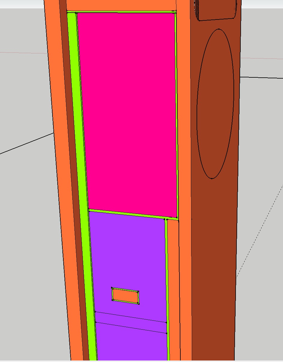

The small box for the woofer is Q .707. All the edges will be rounded over. Also I didn't put it in the images above but I'll likely have another brace in the top compartment that houses the waveguide and CD.

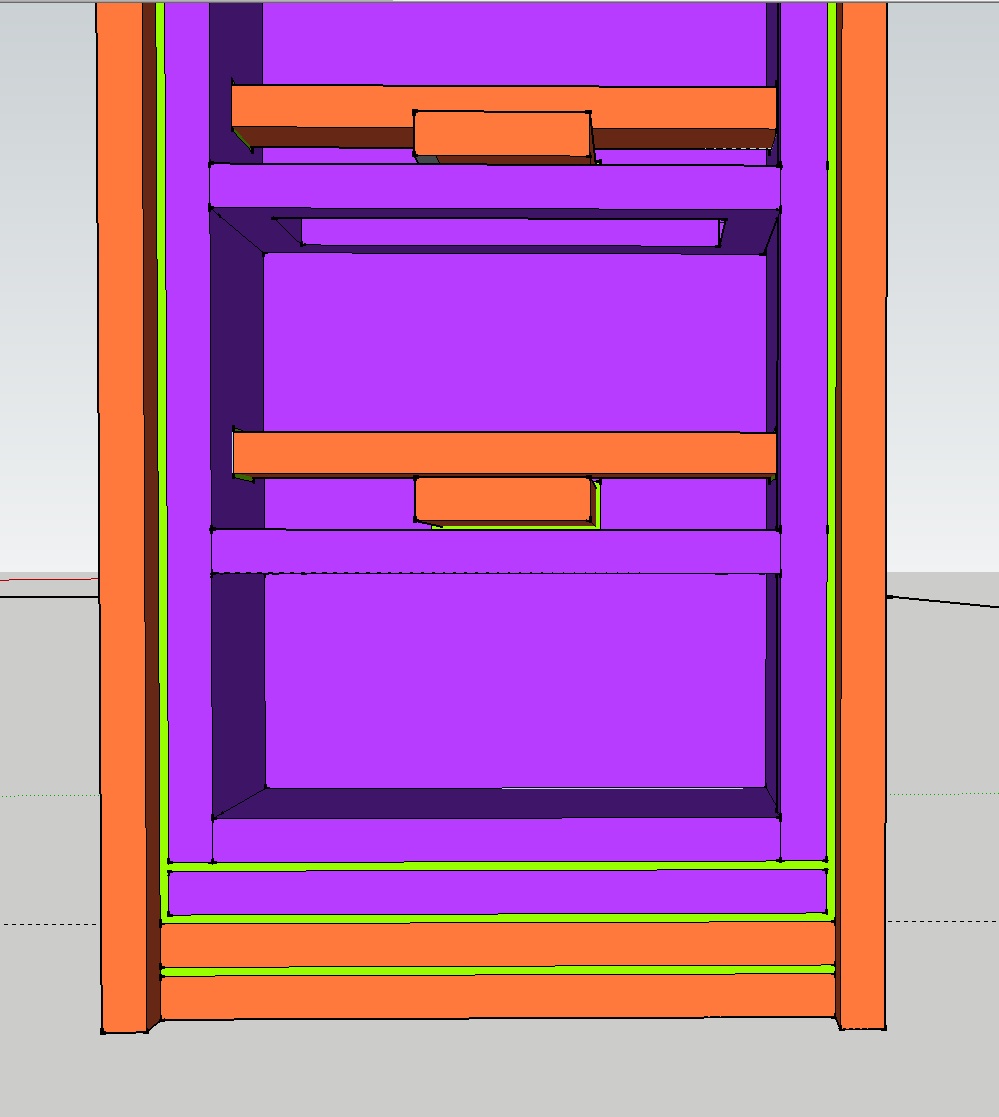

Also the very bottom panel will be attached to the outer panel walls. It will be two pieces of ply, a visco elastic layer and above that will be the bottom panel of the inside cabinet.
Here is what the bottom may look like. I'm not for certain on this. The two orange pieces at the bottom may end up being glued together.
Not sure if you can tell what's going on here, but at the bottom there is an extra section of the orange layer. This is so that I can screw my front baffle onto it, allowing the front (and rear) baffles to be removable. Which allows access to the drivers.
The woofer will be surface mounted on the fuchsia box. and then the orange front baffle will have a roundover that will transition it onto the front baffle. Visco elastic layer between.

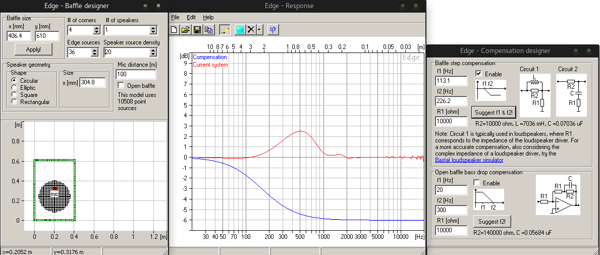

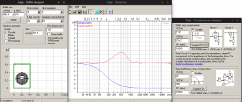

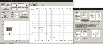

As for edge diffraction due to a lack of roundover, I doubt this would be much of an issue due to the directivity control of the waveguide. It couldn't hurt though. Would be interesting to do before and after roundover measurements at 0,15,30 degrees if possible.
The woofer will not be prone to diffraction due to its limited dispersion above the crossover frequency (the cabinet diffraction should start around 1.5kHz).
Simplistic models from "The Edge" attached...

I think the main reason was that based on the dimensions the speaker looked ugly/awkward as a stand mount. Whereas the floor stander may blend in with the corner bookshelves. I don't like seeing my equipment. The more it can blend in with the furniture the better.
Also I was thinking (tell me if I'm wrong) that if I had larger panels for CLD that there would be more energy dissipation. I also thought that a larger front baffle would control the wave better.

I would make them two cabinets then and decouple them from each other. (I have done this with my speakers in the past.) Then the lower cabinet does not need any bracing or CLD. Smaller panels are always better for lower sound radiation, CLD or not.

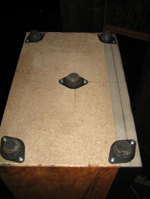

Decoupling, here vibration dampers are of a hollow rubber ball type, vulcanized to a steel flange. Load them with correct max weight on top (according to manufacturers specifications) and it will reach its own lowest possible resonance frequency with at the same time maximum deflection without collapsing (bottoming out). If that resonance frequency is, say, 20 Hz no frequencies from the cabinet above 20 x (root 2) = 28 Hz can pass further into the structure (floor) but will be effectively isolated.
Load it with unnecessarily too light a load and the rubber ball can be seen as "stiff" which results in a higher own natural resonance. Too high a load so it bottoms out, can also be seen as "stiff" with worse decoupling / isolating properties. You want to be close to the "floating condition" which means a speaker that wobbles a bit if you give it a push with your hand. If the speaker cabinet is very heavy compared to the cone weight, the cabinet will not move much back and forth due the cones acceleration back and forth. (It does not take that much to constrain the rocking though if one is anal about it.) With a "light speaker" and a "heavy cone", the rocking movement will be higher of course.
To reach extremely low resonance frequencies, metallic springs would be used instead of elastomers. The vibrations dampers I use will get a resonance of around 14 Hz (9 kg load / damper and 5 of them versus a speaker weight of 44,5 kg.) So, isolation from 20 Hz and up. That gives a good margin, more than 2 octaves, as this speaker shall be crossed over to separate subs at around 110 Hz.

I've had good results using feet like these: https://www.parts-express.com/peavey-large-rubber-feet-1-1-2-dia-x-3-4-tall-set-of-4--248-8786
