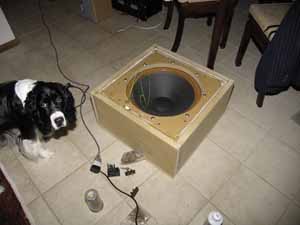

This photograph shows one of the 189E drivers in its small sealed enclosure (32mm MDF):

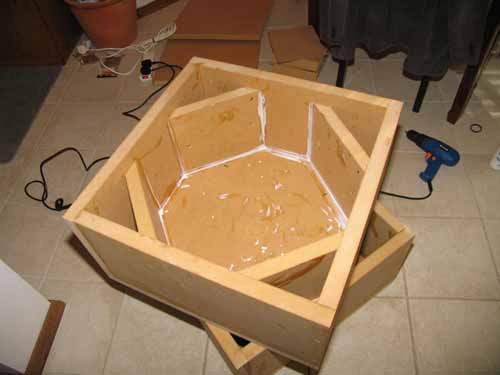

Sorry to dig up an old thread, but I have a few of the 2nd design genuine Universal Studios Sensurround Earthquakes for sale. I bought them thru Clark Stewart back ~1986, when he was the property manager of Universal.
They measure 48" X 48" X 20", and have a single 18" driver. I also have a set of the mouth extenders, so I have the dimensions of them.
These were used in a movie theater in Tuscon, AZ. It was a medium-size theater, so they used 8 subs. I had to buy all 8--still have 4 left. I also had to buy 2 of the huge original ones that used 2 ea. 18" drivers, but I sold them years ago.

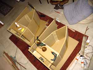

Can't help with the electronics, but the reason for the mouth extensions was to continue the horn flare in order to get down to ~16Hz. Small movie theaters used 4 subs, medium size used 8, and big theaters used 16.
Most of the rear subs fired into the rear corners, so used the walls to continue the flare. But they couldn't use the front corners because that's where the front fire escape doors were. So, they simply laid the front subs in a line across the front and used the mouth extensions for the flare.
I have one set of the originals. They're made from 3/4" plywood. I'll measure them tomorrow. Check these photos.

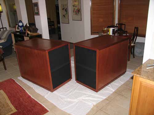

Original Earthquake Sensuorround Subwoofers
Here's a pair that I have had for about 30 years.
These two subwoofers are fully functional and the speaker drivers are the original 189E 18". The cabinets have been upgraded for road travel.
My name is Harry Price. I live in Sacramento, California. These speakers are just sitting in my garage waiting for a purpose in life. Let me know if they are useful to someone. Thanks. -Harry Price harryguitarsolo@gmail.com
