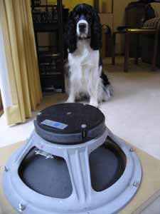

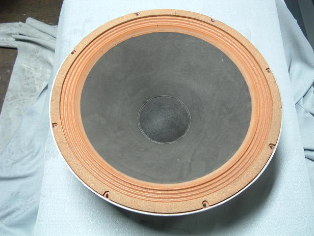

I have included a photograph showing the old-fashioned corrugated suspension of the 189 E driver. I suspect that the Xmax of 5.2 mm quoted by GM is accurate. The cone travel of the drivers as mounted in their sealed enclosures was quite small during a test in which I ran a portable CD player through the A-3000 I amp to the drivers while playing the opening track of the Varese Sarabande CD soundtrack from the 1977 Dracula movie (VSD-5250) which has amazing rumble content for testing purposes. The cones hardly moved but the crockery in the kitchen did and and that was without any horn loading! Actually I have a feeling that the use of a long throw speaker driver in a folded horn cabinet might create too much turbulence in the throat. I considered using more modern drivers but dismissed the idea given that the effect that I wish to achieve was to be as close as possible to real Sensurround. I will post a few more photographs in subsequent links for interest.
